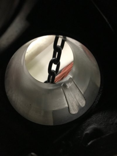

I forgot to attach on last but here is what I've taken apart tonight before I called it a night. I need to get a wrench to take the fan off still so that's why it's on there. Also, some of my **** is ghetto rigged, don't judge haha. My passenger headlight doesn't have the part of it that bolts to the frame so I had to rig it up for now. The previous owner got into a wreck with it
