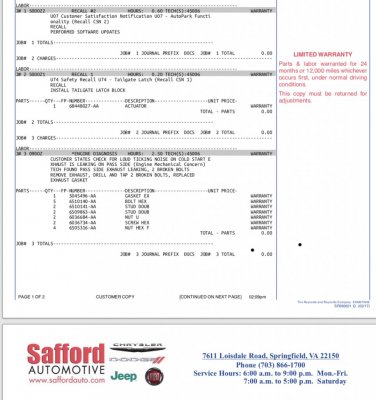

View attachment 144407 Just posting this for reference in case anyone has issues with their dealer. I’m at 40k miles and all work was covered under power train warranty.
How many times did you go to the dealer and how loud did it have to get for them the do the repair? I am hearing a slight pffft pfttt pfttt sound on passengers side at start up. Only lasts about 12 seconds right now. Only 14K miles on the truck.
My SIL's 2012 Hemi RAM has 3 broken manifold bolts on the Drivers side so I'm familiar with the manifold sound.
My dealer took care of it on the first go. I was very specific with my concern. I also brought a video of my cold start. The video helps since the sound goes away after it warms up.
