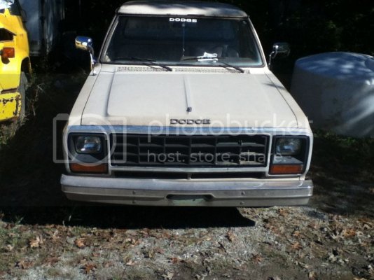

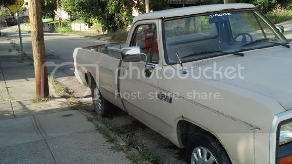

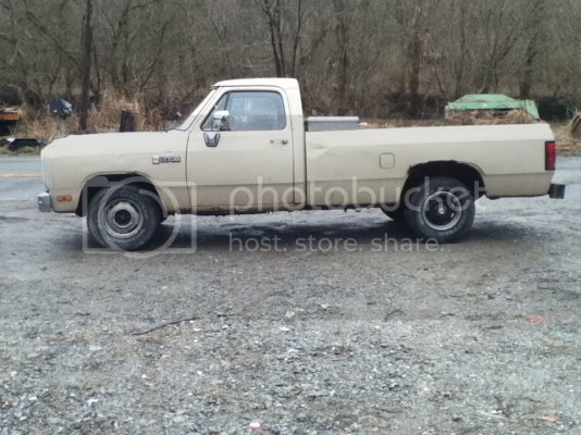

craglist photos from the ad before i bought it

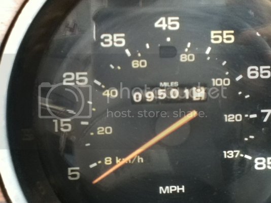

miles when i got it
miles now

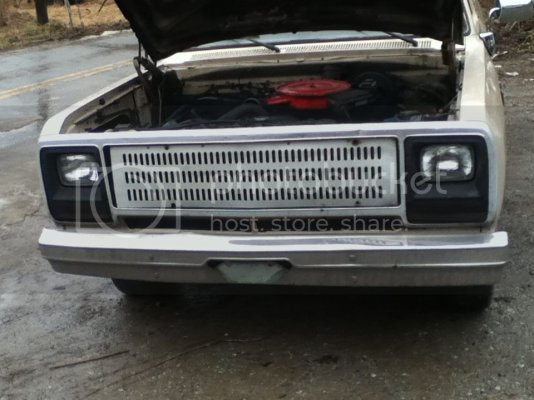

"custom" grill and tinted marker lights

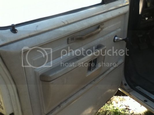

im painting the door panels to match the dash
thats it for to night

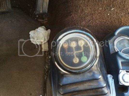

Not a bad looking truck overall, some cleaning would do it good. Being a 4 speed truck, you've likely got an NP435 which means OD is actually a 1:1 ratio...not exactly great for MPG.

your truck should have 3.21 gears since you have a standard transmission. i know my 81 use to have a /6 and standard transmission at one point in its life and it has 3.21 gears. you want to keep those. they are what will help you keep your decent gas mileage especially when doing highway driving. if your getting 21mpg you are getting about the best you will see. you could try installing electric fans but i don't know of any that bolt on perfectly for the smaller /6 radiator.
