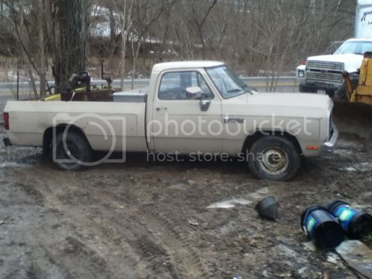

Haha! That '89 is sketchy!
I dig the 'rat rod' look to it though!

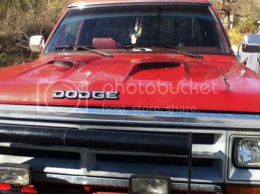

just going to share these here.
I really like this hood. its made with Cuda hood scoops
