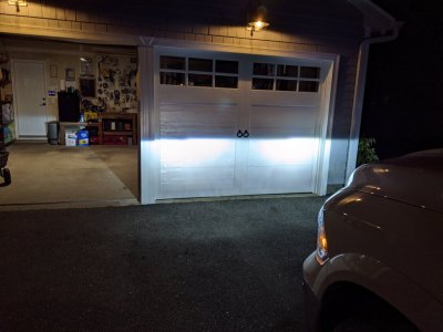

Got my ddm ultras installed, used the brightsource dust covers just so i didnt have to drill the stocks if i ever go with leds instead.
Gotta get use to the white light i guess, not sure i can actually see better at night! Gotta test more and fogs would prolly really help.
Couple pics, looks brighter then it really is as others have mentioned when posting light pics.

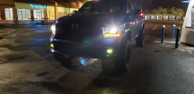

I would recommend getting Hylux 45w ballasts and Morimoto 6500k bulbs. I’ve had plenty of problems with Morimoto ballasts, but their bulbs have been fine. Hylux ballasts have been great for me (both 35w and 45w). The higher wattage ballasts will reduce the specified color temperature a bit. The 45w ballasts and 6500k bulbs in my TYC projectors were pure white, no blue. The 5500k bulbs with the same ballasts were quite a bit warmer in color, but with 35w ballasts were pure white.
I tried a 35w 5000k innovited kit, and the bulbs were trash. Almost green in output. The ballasts were fine (used them with some Morimoto bulbs with no issue).
Check this out on the Hylux ballasts
http://www.morimotohid.com/amp-xb35.html
Oh yeah and going on three years of using HID's on my truck now. 20181231_210745.jpg
