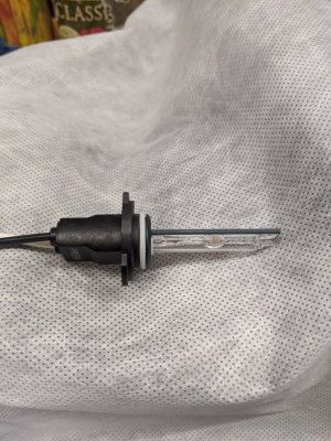

How do you clock the ddm tuning ultra bulbs? I twist the bulb in and the bar sits at 2 o'clock. I dont see a way to spin the bulb itself in it's housing.
you loosen the 3 screws on that hold down plate that clocks the bulb with notches on the headlight, this allows the bulb to turn, then re tighten the screws

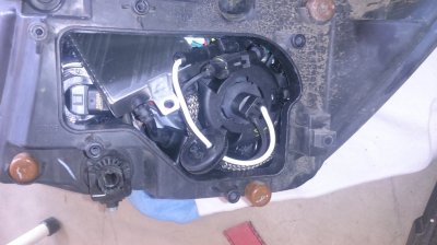

Jb1, i know you have these, where did ya mount the ballast? Im thinking of just getting the led hikaris cause i didnt really wanna drill a hole in the dust cover. I thought i could fit the ballast inside housing but not with these ultras!
They’ll fit
These are Morimoto but watch this video

Hmm mine are the ultra, are those the plus? I could not get mine in like that.
Just found this pic online
You do not need to clock a hid bulb, the capsule isn't adjustable, so your bright spot never changes. Unlike an led bulb where you need to change the direction of where the chip is pointing.
