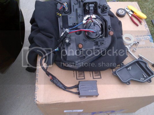

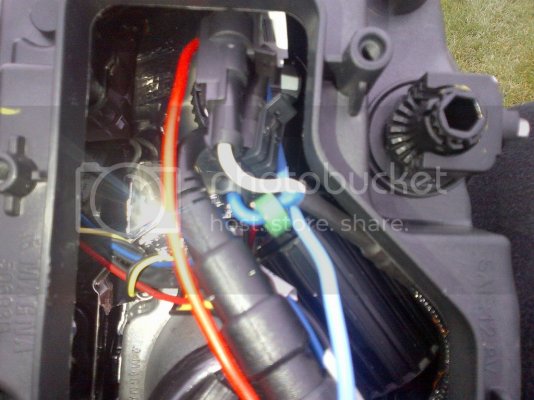

There are a LOT of us that would strongly disagree with several statements in this post...
Jeremy has sold a TON of Morimito HID systems to 09-12 and 13+ Ram owners
For heads and fogs utilizing the stand alone canbus adapters instead of a relay harness with no issues at all....$30 and nothing else. :favorites13:
(other than a ballast and HID bulb)
Can-Bus: Morimoto Standalone - Wire Harnesses - Components
I've got them driving the HID's in my 10' with retro'd 13+FX-R projectors and 10' Sport Fogs
and I know many with 13' and 14' Rams running the same setup....absolutely no relay harness at all...
...some even tuck them right inside the lamp housing on the 13+ Projector for a clean install
Trouble/flicker free for over 6 months so far... (35w/5000k) even when temps drop as cold as -35º
