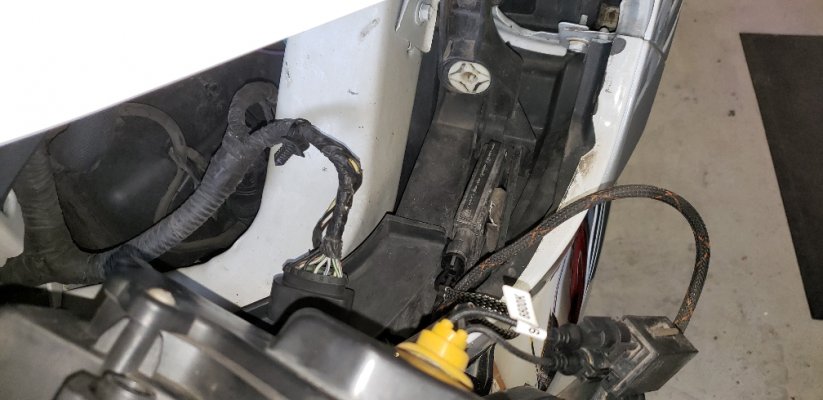

These are fun to put HIDs in aren't they? FYI I have Morimoto HIDs with the XB 5500k bulbs and they fit under the stock cover with a hole drilled for the grommet in the same place. Mine have been running for over 2 years and I just replaced the bulbs which I expected since I'm running a 55w ballast. I was able to tuck my ballast under the headlight sideways. There's a nice little void. I have a 2013 Ram 2500 with the factory projector lights. (I actually replaced those with the blacked out TYC version and they have better cutoff than the OEM ones.) I have gotten both TYC lights replaced under the lifetime warranty and there were no questions asked. (If I recall I was getting condensation in the first set.) The attached photo shows the ballast dropped into that void under the headlight area. Nice video, I'm sure it will be helpful to others! 15900f94b14e513742ff5f8b3dd612bd.jpg
