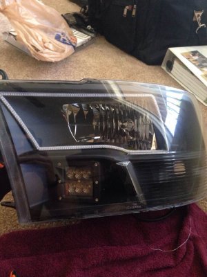

I did the same thing but I made the headlights myself. I noticed the same thing. The high beams aren't as bright as I would have imagined but I am running 55w hids in my low beams so just like stangshcky12 said the low beams have more output than the pods will. ImageUploadedByTapatalk1409497799.237989.jpg
I mainly did this to get rid of my halogen high beam bulb I still had. I don't offroad my truck anymore.
