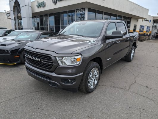

I ended up buying one today! So stoked right now!
I was watching the prices on the 2023's and was about to get this one for $49K. Not very fancy, but does have the Sport and trailer package, heated seats and steering wheel. 8.4" radio.
I had gone to a closer dealer yesterday for one that was pretty much the same price, but had a few more things. Turns out they had about $6K worth of very lame add ons. Only about $1K that could be removed, so would be stuck with an extra $5K of junk. Left there pretty pissed.
Searched around a bit and found this one about an hour away. Called them and they confirmed NO ADD ONS unless I want them. Got in and out of there pretty quickly.

That’s a beautiful truck! Enjoy. I have never been in a better riding vehicle. These trucks are amazing.

Thank you sir!
Yeah, the smooth ride quality was a major factor for me. I was considering the F150 3.5 EB. Wife has an Expedition with the 3.5. Just by chance, she was in a minor fender bender. The Expedition is in the shop. She signed up for an economy sedan and they were out. So they gave her a '23 F150 with the 3.5 EB and 4X4. She new I would be more than pleased to have an extended test drive. I did also at one point have an '18 F150 2.7 that I traded for her Expedition.
Both F150's (my old 2.7 and the '23 rental) weren't terrible. Just not as smooth, more bouncy. Likely because of the rear leaf springs vs. the Ram coils. My commute has a section of freeway that I refer to as 'the woops'. In both F150's (and my '04 Jeep Wrangler) that section is VERY bouncy. Barely notice it in the Ram. Same with other things like crossing train tracks. The Ram just glides over it. Don't have to slow down as much to avoid losing a filing.
I'd be tempted to get a small lift to fit 35's, but don't want to gamble with my smooth ride, or degrade it's towing ability.

I agree. My last ram got oversized heavy tires. It was the old 4.7 in a work truck, st. Between the engine and the transmission, it wrecked what little pep that truck had. I still abused it for 10 years and loved it till the day I traded it in.
This time I bought a Laramie that I loved the appearance of as is. It rides so beautifully I don’t want to mess with it too much. I did add some air bags to the back for when I haul/tow without a wdh. That’s it for performance purposes. I always add steps and a topper. It’s a true old man truck now,lol.
