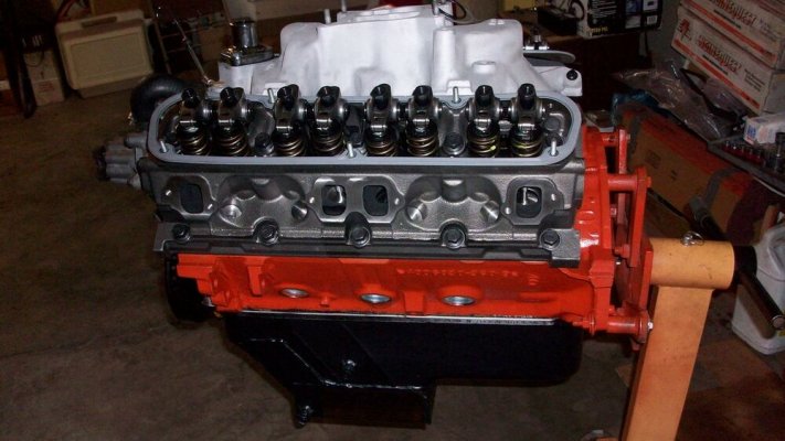

there is no reason why it wouldn't fit. just dropping a LA block where a magnum block was factory is not a bolt in job. you would have to do some fabrication to get the job done. people have put 440's in 2nd gen ram but it is still not bolt in.
la engine block
magnum engine block. the 3 holes in a triangle shape is where the magnum motor mounts bolt which LA engines do not have the holes for but you can see the magnum engine has the ears for LA motor mounts to be used
la engine block
Were both right.
Magnum is easy bolt in where LA was.
LA can go where a Magnum was with some modifications and easy fabrication.
