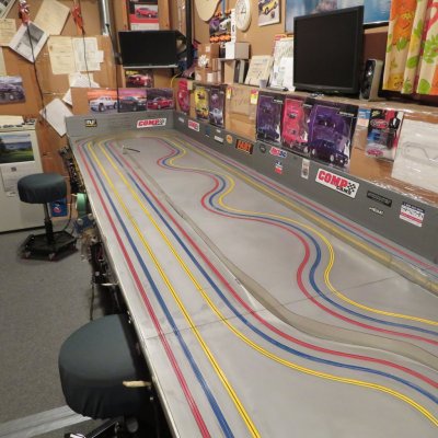

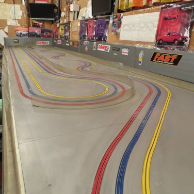

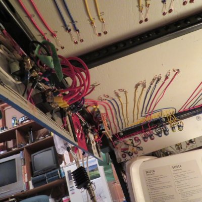

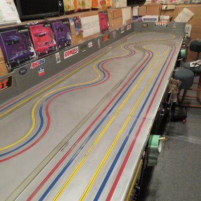

I haven't played little toy race cars in about a dozen years .Ran into a bunch of local guys who are just getting into the hobby,and they convinced me to clean off my old track and join them.Then i decided to go looking to see if i could find the group of guys i used to race with years ago,and be dammed if they aren't still racing. There's a short little 45 second video posted on this page for anybody who wants to check it out.
Anybody in the southern Alberta area who wants to join in,they're always looking for more guys
There's tracks in High River / Okotoks / Beiseker / Airdrie / Carseland
The fan cars are some of my favorites,no traction magnets,and just air pressure from the propeller to propel them around the track,means it takes some skill to get them through the corners,lol

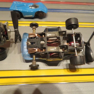

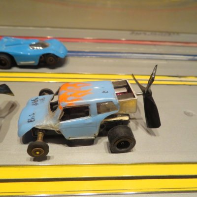

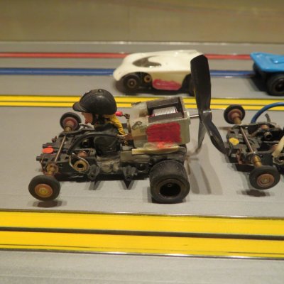

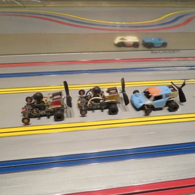

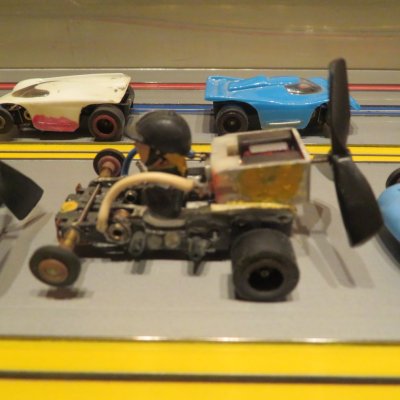

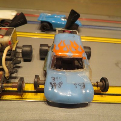

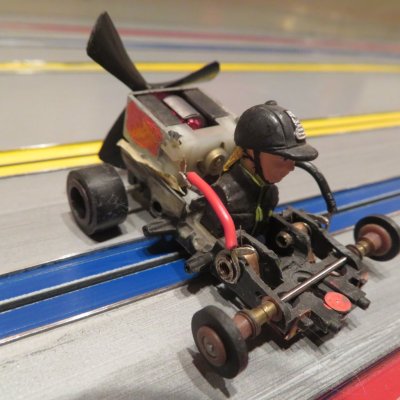

Never have seen prop driven slot cars. Mine were electric with no traction aids.
They're a riot,as they take some talent to make a corner at decent speed,lol.
I built them about 15 years ago,and there was a pile of experimenting to get them right.
I built a jig to cut the props all to the same length after i finally figured out what length was optimal.You can't buy the props in the right length,so you have to mod a longer 3 blade prop by cutting about 3" off the blades.
Then it took a bit to finally figure out the angle i needed to mount the motors on.The motors need to be angled down,so the props air pressure puts some weight on the front ends to keep the guide pin in the tracks guide pin groove.If you mount the motors level with the track,they'll actually take enough weight off the front end when you pin the throttle,that the guide pin will lift out of the slot,leading to an instant deslot. Now if you were good with a computor you could probably map everything out,but when i built them,it was alot of trial and error and a whole bunch of head scratching to get around some of their inherent problems :waytogo:
They're actually faster then you think,if you're into the hobby and have heard of "Fray" T-jets,they'll easily beat a Fray T-jet down the straights,but with nothing to slow them down,you really have to plan for the corner at the end of a straight,as they like to coast forever,lol.
They use older Tomy Turbo can motors to run the prop,with some lead weights glued into the bottom,so they're not as top heavy

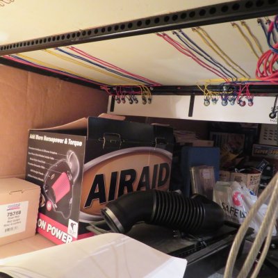

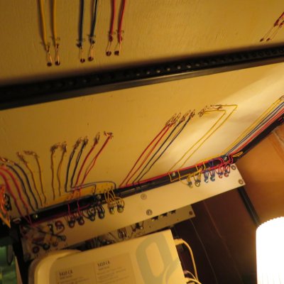

My track is wired for directional switches,so if you're on the ball,you can throw the prop into reverse,and they'll slow down then,lol

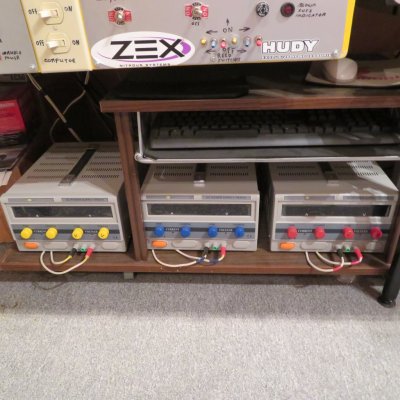

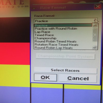

If it's been many years since you played with them,the timing systems have progressed alot,lol. My Track Mate system is 15 years old,and it's outdated now.It times down to the thousandth,and gives you the scale mph,and also runs the track,but the newer trackmate systems do even more

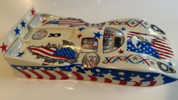

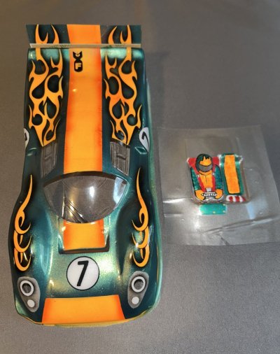

I've been racing 1/24 scale most of my life. 70 now and still going strong. Run a series at tracks in CT,MA,NY called NERR (New England Retro Racing) and Friday nights at the local track. Also compete in some bigger national races were we get guys from all over the country, Canada,Japan ,England ,South America. Met alot of great people through the years. Favorite part is painting the clear lexan bodies.
