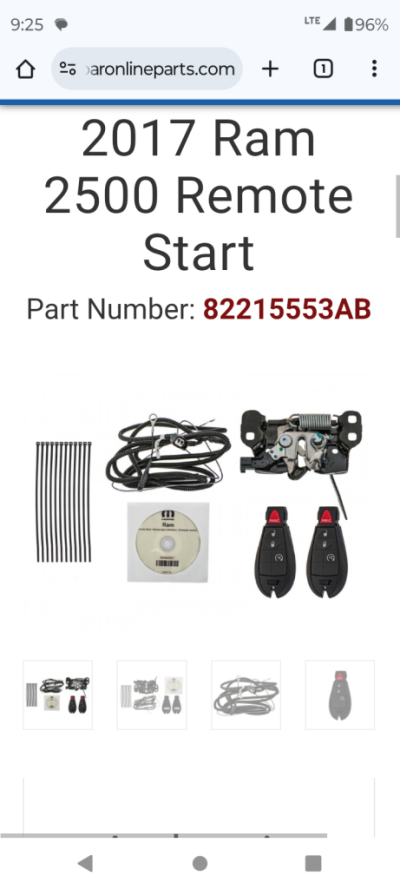

Just purchased the OEM remote start kit on eBay. It came with the hood latch and two fobs, easy to install. Got the kit for $250
Does the truck already have the wire and plug to plug in to the new hood latch?

Could you provide a link?
I used Moparonlineparts.com when I ordered my remote start kit for my 2017 RAM 1500 HEMI.
It didn't mater that the kit was for same year 2500/6.4 liter HEMI.
All I needed from the kit was the two key fobs and the hood latch with the sensor, my truck came from the factory already wired for the remote start.
I installed the latch and went to the dealership to have it "programmed" for the remote start feature, $70.00.
