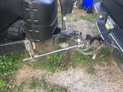

My wife and I have been looking high and low for a right fit for our truck. I know we're toward the top end on the scale, and everything is purchased, so no going back now... having said that, what type of trip would you feel comfortable doing with this setup? Two adults, and two pre-teens.
2016 Ram 1500, 3.21 gears, crew cab, 5.7 Hemi.
2018 Coleman Lantern 274bh.
28.58 feet in length
Dry weight 4676 + Payload Capacity 2924 = GCWR 7600
Hitch Weight 568
I have added a Husky 32218 Center Line TS weight distribution bar.
Knowing all this, and being my first time hauling something this size... is this setup capable of cross country traveling into the mountains? Or is this really more of a setup for 200-300 mile local camp sites?
The best part, everything is paid for! Upgrading to a bigger truck isn't an option for me, because we have the MOPAR lifetime warranty... so I'm invested in this truck and don't plan to replace it.
What say you? And thanks for the opinions!

Why did you end up going with the Husky 32218? Wouldn't the 32217 be a better fit for your setup?
B
breal201999
Aug 7, 2016
278
191
I think it cost me $5 more for a bigger capacity. The 32217 is 600-800 range, the 32218 is 800-1200 range. My logic was bigger is better/overkill, but for $5 might as well. Unless you MUST fall within the range, then my logic was flawed! Any harm with what I got?

The Husky TS Centerline is a very good WDH and has the sway control built in. My son has the same WDH and hid towed phenomenally 1400 miles last week (I drove about 500 miles of it) but he has a 2500.
We left Tuesday morning (the 22nd) at about 7:30AM EST and stopped about every 200 miles for fuel (got 8.0-8.5 MPG hand calculated). Drove between 65-70 the whole way. We stopped in Little Rock, Arkansas (left from Pittsburgh, PA) at about 1:30AM CST so drove about 18 hours that day minus about 2-3 hours for stops for fuel and food. I drove about 5 hours of that 18. The next morning we left about 8:00AM CST and arrived in Baytown, TX at about 5:30PM CST so about 9 hours minus an hour or so for stops. If your wife can drive some of it then 1200 is doable in 2 days. Granted the 1500 will probably be more mentally exhausting than the 2500. Handling wise we really couldn't tell the TT was behind us.
This Hitch is NOT a sway control hitch.. It is strictly a weight distribution hitch that keeps your tongue level with the truck, true sway control hitches actually use hydraulic cylinders to dampen sway.
What this hitch does is keep your trailer and truck level with each other, that is what those arms do, they act like a leaf spring between the truck and trailer--keeping it level.
The sway control effect comes into the picture by keeping BOTH the trailer axles loaded, that is to say when you have too much tongue weight, the trailer dips down lower in front, you remove weight off the rear trailer axle, that makes the trailer susceptible to the sway.
Single axle trailers are more prone to sway, due to being improperly loaded, wind ect. for the most part that is why travel trailers have two axles to reduce the effect of wind etc. They could easily put a single 10,000 pound axle under them, for the most part it would be cheaper, but then you would not have the pulling control, two axles are more stable.
So you see, that is why its called a weight distribution hitch, sway control is just a benefit.
