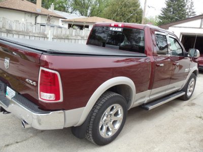

2019 ram 1500 sport long bed
5.7 3.92 4x4 ruby red
1223v springs installed :roflsquared:
