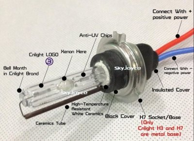

Should be down, its possible to get it right, remove the 3 screws on the bulb retainer, place bulb properly and reinstall the holder

It's the wire that runs along the glass. It has a ceramic coating I think. Might even be a ground of sorts. Broken wire, no light.

Sorry, I thought most knew what the return wire was on a HID bulb. Below is a pic of it, but in this pic it is just called the "ceramics tube".
