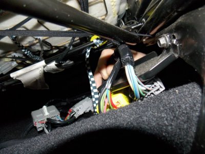

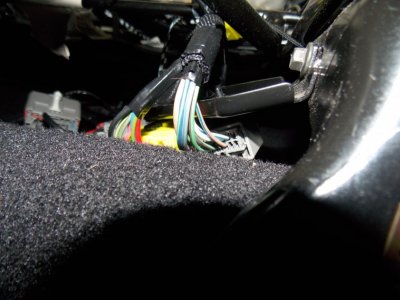

To be honest I had not looked yet, but here is a pic, I think I have all the wires but need some one who has done it to look. Hope the pic tells the story tough to take at night.
DeereGuy
Nov 9, 2016
623
589
Pittsburgh, PA
Yep looks like you have all the wiring. You should be good to go.
