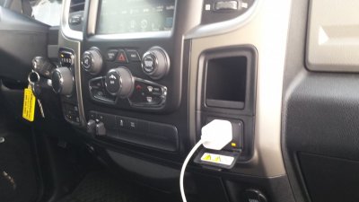

I saw the inverter code in the list if options when I was looking around with the tool. 00/RT enabled the option on his truck and couldn't get his inverter to respond. He was able to get it to work by rerouting the inverter trigger wire. I didn't bother trying to enable it because I didn't have the correct wiring in my truck anyway. I followed his post on (adding factory inverter) and wired everything up and ran the wire that is supposed to go to the BCM for the inverter trigger to accessory on positive and it works great. Just another option if yours ends up not working when you enable the code. Your truck should have all of the wiring all you would need to do is reroute one wire that plugs into the outlet in the dash.

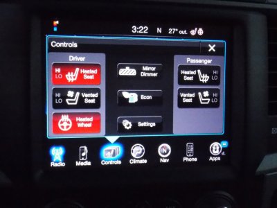

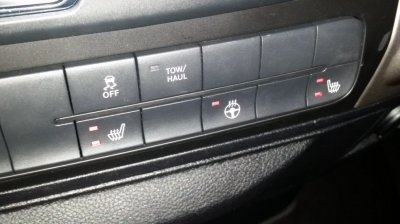

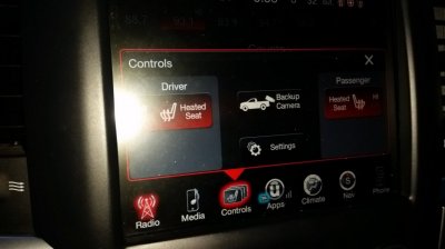

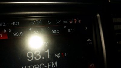

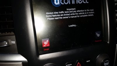

So had the dealer install the clock spring for me today (last one I did went horribly horribly wrong!) So anyways ..... I now have a heated wheel!!! They didn't add any codes, and I have soft keys for the seats, and the drivers seat and wheel turn on with the remote start. I pretty much have everything.... except a soft key for the wheel.... couldn't be happier. I honestly didn't expect it to work at all and had accepted that I was going to need to buy a programmer. So good day for me! The dealer did do 2 free software flashes...IPC and ITBM.I have no idea what that is or if they have anything to do with this mod. Truck is a 2016 Express with 2016 Big Horn SLT front seats. Again a HUGE thank you to RicksRam and DeereGuy for all of their help! Never could have pulled this off with out them!
I really bet that they added a code for you of some sort and just didn't disclose it. Who knows though. Until we get more test cases, I guess we won't know. All I know is Good for you!!! Congrats!
Ricks Ram
Ricks Ram
May 1, 2015
4,411
3,417
The dealer would have to go through WIC to get the codes added as it's not available in our list of options. I have heard Chrysler has cracked down severely on dealers going through WIC to add codes I'm also not sure they could do it that quickly. It would also seem that if they had the heated seat code added they would have also done the heated steering wheel. It seems crazy but maybe when they did the reflash since the heated seats were already in and working it just picked up on them somehow I'm not sure but like Deer Guy says IT WORKS! and that's the main thing. We will have to get more trucks done before we can start figuring out a pattern.
