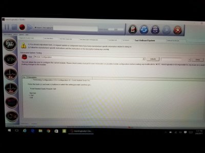

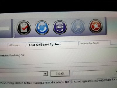

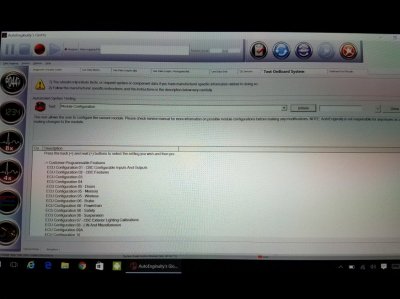

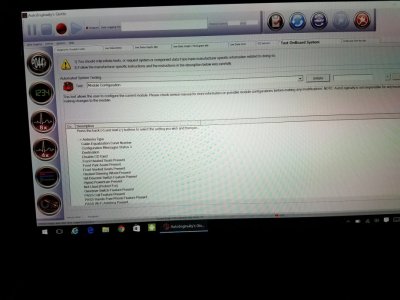

Module #3 once you are in there and module #5 memory I think will have all your ventilated and heated seat options. Set them to yes and it will say complete, then initiate again and repeat till you have them all. Disconnect and shut down the truck, get out, lock the doors, and get back in. After a few of those all the settings will start to take place. It took 1 for the hard buttons to work, 2-3 till the radio soft keys showed up.

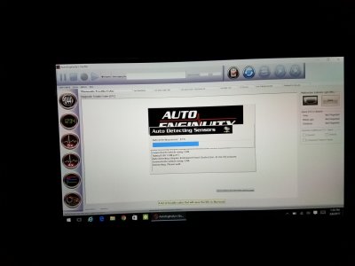

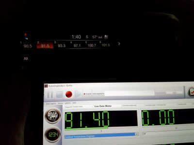

any ideas on the temp now? I get done and notice its cold out, but its 85 out. The truck is reading 91 degrees in the scan tool

Pulled the battery, and now the temp is right, and the seats are starting with the truck remote start.
