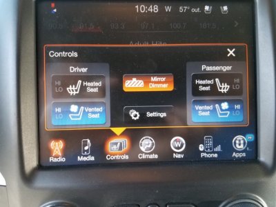

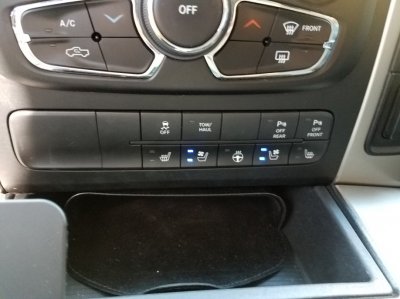

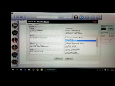

So whats the trick adding the soft keys to the radio? Got the hard buttons to work finally, longest week of my life. Now just need to add the to the stereo! Thanks guys for the work.
DeereGuy
Nov 9, 2016
623
589
Pittsburgh, PA
Go to ECU3 and turn them on there.

Thats where the hard buttons were, but it didnt add them to the controls area on the 8.4 radio. ECU3 worked for making the hard buttons work though. Almost too easy, and my chrysler guy said impossible to get them working at all. :roflsquared:
Well I went back out to the truck and there they are, now to figure out how to add them to remote start.

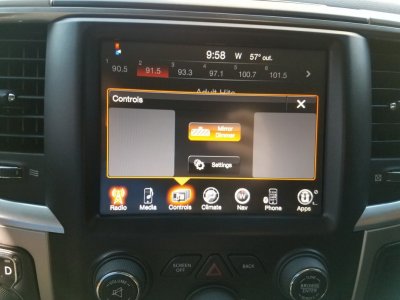

I set everything in 3 first, didn't look at 5 at all. Left the truck wondering what I was missing as the hard buttons worked after an ignition cycle. Went out the screen was blank where the heated and cooled would be, read the radio, climate control, and heated seat module which had no changeable settings and went back to body control, read the door module and it had setting in it and when I went in the ventilated seats and heated seats were already set to present. 1 more ignition cycle and they showed up in the radio.
I think reading the modules it polls the bcm and added them as it is the master of the truck. I could be wrong but it worked?
I'm 100% I made the changes in 3 not 5

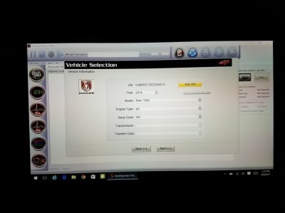

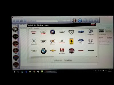

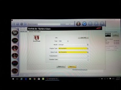

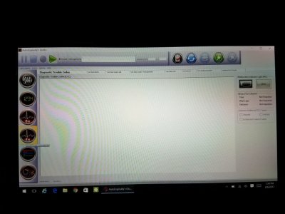

Can you guys post some screen shots of the screens you are in where these changes are made? Actually a video on youtube would be awesome, probably asking abit much. I am sure I can figure it out but would be n ice to see.
WilliamS
May 3, 2016
2,638
1,195
Tampa FL
I'll give it a go later, no idea how well my phone will pick up my tablet screen
Can you get your computer connected to wifi while plugged into your truck? If so we could do a screen share later tonight and I'd walk you through it.

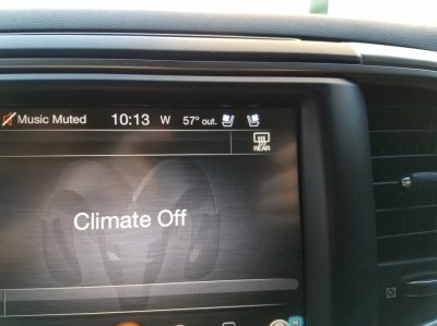

Strange anomaly, my outside temp is stuck at 57 now
