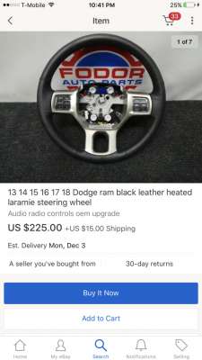

IMG_3187.PNG If anyone is looking a heated wheel for the swap there are 3 on ebay right now from same guy.

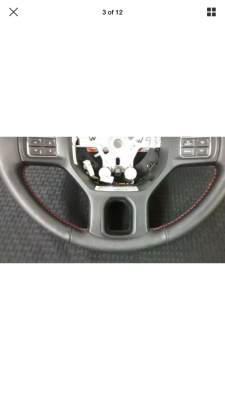

How about a mod on top of a mod?
Change the thread color of a steering wheel, to match custom Katzkin covers. Anyone ever tried it?

I think it would look really cool but I dont know what the stock leather wrap looks like once removed. I have a two tone set of Katzkins (lapis gray and cardinal red), could use the same color stitching on the steering wheel, or at least just the red to match the seat stitching.
Oh and to make it more complicated, I have the heated steering wheel.

3 min in and he's maybe 1/2" lol. And it's time lapse. More power to ya if you got the patience for that one. Would definitely be a custom touch no one else has.

Yeah I saw the Rebel one, too expensive for my blood.
I was able to get an excellent condition heated black leather wheel for 140 shipped. Will probably just leave it at that but while its sitting in my basement taking up space would be the perfect time to mod it :)
