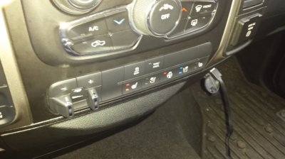

and your dash bezel lights up for both heated and cooled right?
Yes your truck will have all of the wiring for the heated wheel. As stated all of my lights in the buttons illuminate. They all worked before I ever added the codes.

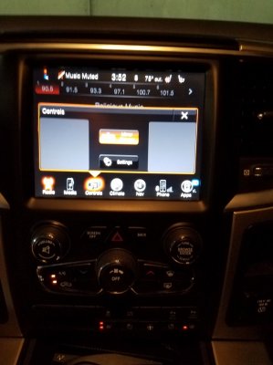

My heated will light up, and funny enough show up on the radio! The cooled buttons do nothing at all, and I dont have the wheel to test. I never intended on the wheel and if I dont have to spend the cash I would rather not. Its not a huge need in Florida.
Adding some pics because I thought it was interesting that my seats show up on the radio without it knowing it has those options.
Those icons will show up because the radio just sees a "heated seats on" message and doesn't consider anything else. The codes will get you the soft keys on your screen so you can turn them on from there.

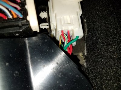

I am honestly at a loss to what the difference may be. There is something we are missing. If you have a Multimeter I would suggest starting the truck and see if you have power to the two pink/yellow wires in the drivers side seat yellow plug. I have mine hooked to a relay to have power when ignition is on run. That is the only thing I can think of where my truck may be different. So I recommend starting the truck and checking those two terminals for power in the yellow plug then turn on the heated seats and then see if there's still power to both pink/yellow wires my truck has power to both of those terminals all the time when it's running because I put it on a relay I'm thinking that may possibly be something that's different. Maybe I inadvertently bypassed something by hooking mine up directly to the battery in a relay where I'm getting power to the modules needed and your truck doesn't Supply it when the heated seats are on
Ill take out the meter tomorrow and give it a shot, its wearing thin on me. Pulling apart 2 trucks to test the wheel theory really has me pulled apart. That any my wife being sick for 2 weeks and losing a loved one last night. I might just be tired but something has to be up! Also here is the harness, if you can see if there is something missing?
Also on the diagram for the seat the pink/yellow(orange) is not in the diagram but they are in my harness. Should they be 12+?

So you are saying the pink wires with orange striped in your harness are 12+ when running? There are 2 in there. The power seat works, the heated in the back and bottom work, so in terms of function those work great.
82990d1484547924-adding_heated_ventelated_seats_heated_wheel_express_tradesman-20161222_134900.jpg
The pink wires in opposite corners you have 12v all times when running.
