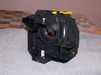

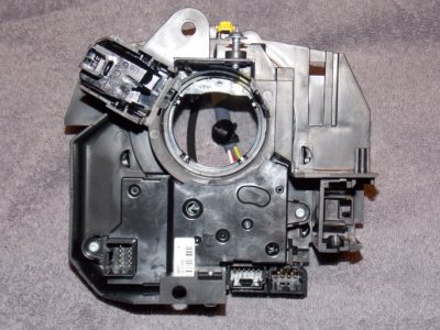

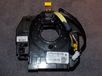

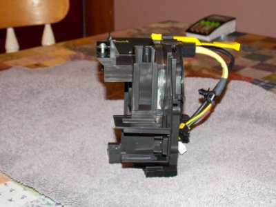

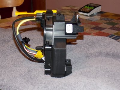

I was also very confused by Willams and also wonder if he partially disassembled the clock spring? I also have taken a few of these steering wheel an clocksprings off and his post confused me. The fact that they were different? Maybe he disassembled the different clock springs? Anyway just thought I woul take some pics of my new clockspring for comparison,

Thanks for the pics! I only had a few crappy ones. Those last two show the slots on the side for the signal stalk and the adjustable pedal switch (or filler plate).
See how there are two separate labels with part numbers? I bet that center piece pulls out along that square wave looking junction at the bottom left and that's what WilliamS did.

Thanks for posting that video. The pictures I posted are of of the clock spring as it is sold by and meant to be serviced/replaced by Fiat as a unit.
So again the reason yours was different is the housing and the clockspring are sold and serviced as one and not meant to be taken apart!
Even though that is what they did in the video. Also I have never seen that dampener before and I have changed over half a dozen of these wheels?
Obviously that video was not made in a US truck. What I found very odd was friggin with the airbag while the truck was powered and running that is completely friggin stupid!!!! This guy is a fu##ing halfwit!!!
If you look at the bulletin I posted in post 124, you will see the heated wheel plug that plugs into the back of the clockspring, on non heated wheel trucks it is there sitting in a plastic holder.
In figure 4 of the same bulletin you will see no dampener like he mentions.
The Skinny is RT was right you actually disassembled the clock spring.
Oh and one last thing there are two part number tags on the new assembly one on the actual clock spring and one on the housing but they are the same p/n 68110740AE.
