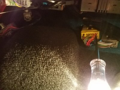

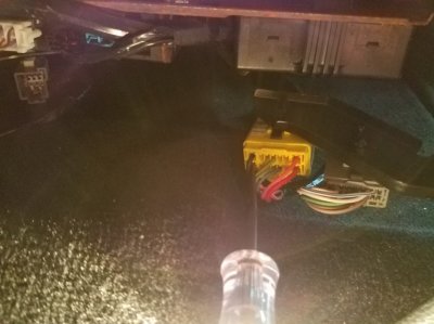

Power on all 3 with truck running and heated seat on full, also with them off, and even in aux mode there is power on all 3. Has to be something in the data loop, just has to be.

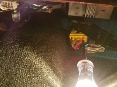

Also from the pics, on the left there is a gray connector, 6 pins, theres nothing in it?

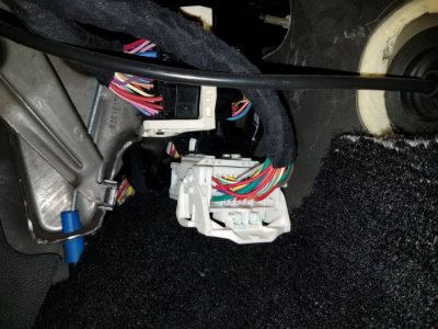

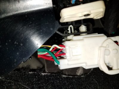

This is where I tapped into the heated wheel wires. I had them entering the right side of the plug but not exiting on the left side so I had to pin them thete. See if you truck has the Dark blue/Light green and a gray/Light blue wire going into the right side and then see if there is a corresponding wire on the other side of the plug. I started from scratch and wired my truck and everything works perfectly we can figure this out we just need to find out what the difference is we can rull them out one step at a timeu

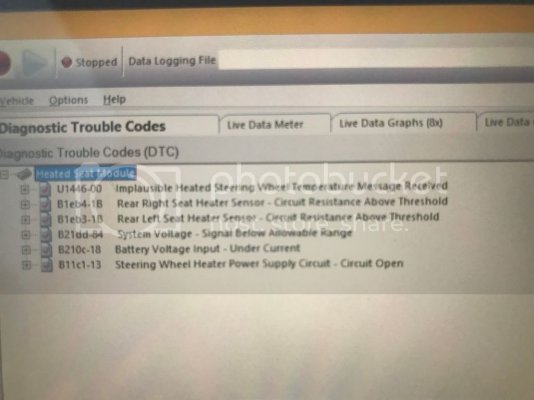

Here are the errors that I have logged in my heated seat module. I couldn't figure out how to command the functions on in the couple minutes I had to look at it.

It seems to be picking up trouble codes for your back seat for some reason they should not even be attached. I just thought of something that I'm not sure if it has anything to do with her or not but my seats came out of a quad cab without the rear heated seat option. Is it possible that there's a different heater seat module for a truck without the heated rear seats as compared to one with?
Do you have the cooled seats in, it doesnt look like it either sees them or there are no errors for them if you have them in there.

I'm a bit concerned about those voltage codes the module has stored. I wonder if there is a power path that is missing.

The only power path that I didn't put in per the schematics was the 20 gauage 10 amp F928 circuit that ran to the center console heat buttons. So I'm not sure. I didn't have the truck running, just the key on when I took that screen capture. Not sure if that makes a difference or not.

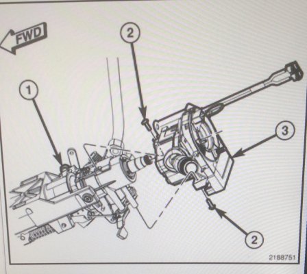

I'm not sure what you're talking about with the bracing and the steering wheel snapping in. I've had 3 different clocksprings - a '13 1500 without heat, a '13 2500 with heat, and a '15 1500 with heat. They are all identical externally with the exception of the heated ones having the extra lead at the top that plugs into the wheel. I just pushed the tab on the wiper stalk base, slid it out, and popped it in the new one. Rick did the same on his truck going from his stock '14 one to the '13 heated one I sold him. The only other difference is that the Laramie probably had the adjustable pedal switch on it. That swaps out though, too. The other trucks just have a spacer. I don't know if it has anything to do with why it didn't work, but the fact that it didn't swap right in like it should makes me wonder if everything was setup properly when you put it in your truck.
Ill get a picture Monday. I assure you they are not the same. The clocksprings are the same size and shape other than the heated wheel wire, but the housing that holds the clockspring is not.

That's the part that I'm missing. There isn't any housing that holds the clockspring. You pull off the wheel, you unbolt the clockspring from the column, and then you just have a bare steering column with a protruding shaft. I'm kind of feeling like you may have disassembled the clockspring and only swapped over part of it? I'm not sure.
