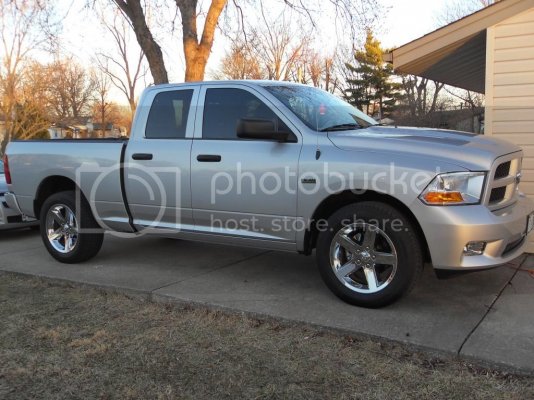

View attachment 21629 I'll be doing this sometime this week. What does everyone think, keep or loose the hemi badge on the fender?

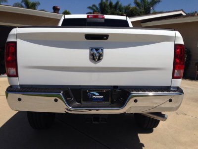

What about the new 2500 tailgate ram badge?
So there are a ton of 1500 examples on here, but has anyone tried removing the RAM badge from the tailgate of a 2014 2500? It doesn't look like the indent in the panel is there that you usually see on the 1500's, but what about the pins? And holes that could possibly remain?

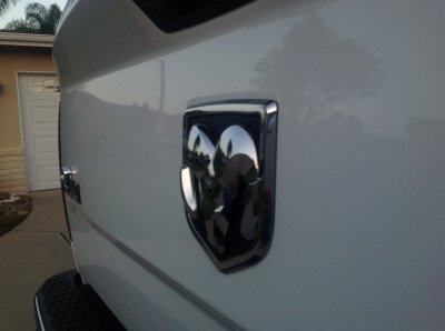

Here is the RAM photo.

The tailgate badge has holes for prongs in it. If you remove the rear badge you will have holes showing.
Only way around this is to have the tailgate shaved and filled to cover the holes.
