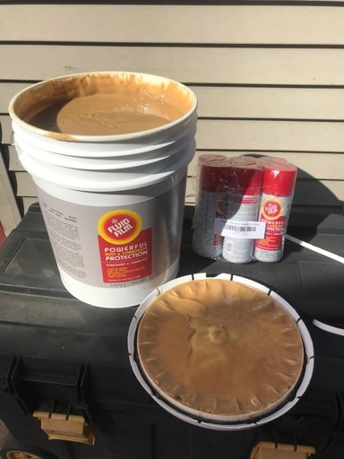

If you get one of those drill-driven paddle attachments, stir up the 5 gallon for a few minutes with it and it will get a little easier to flow and more like a liquid than a paste. Once I did that I was able to (easily) spray it with the $20 harbor freight electric sprayer.

I use a bent filler rod or coat hanger on the drill[emoji16]
I still may heat it. It will atomize much easier when warm.

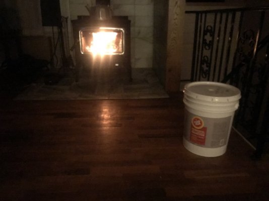

Today is the day. Used a vacation day to get it done. Put the FF in the stove room last night to get it a bit warmer. It is still nice and fluid..... unless i put it outside.

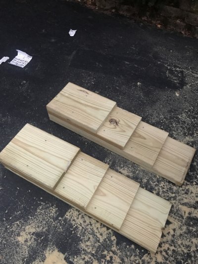

Forgot my tyvek suit at work[emoji23][emoji16]. Guess i am finding some disposable cloths[emoji23]. Going to used my new ramps to give me more elbow room under the front of the truck

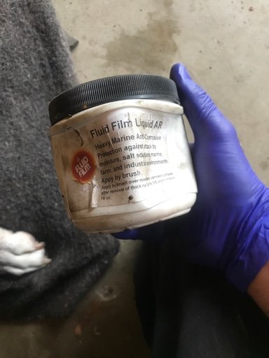

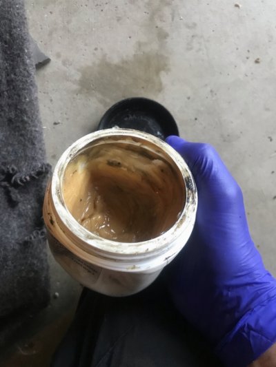

Well i dont know what is going on here.
This is the website I got it from and I think Cory got it there too. It looks like they’re changing their website and their product line is also changing to something called “WOOLWAX”
https://www.kellsportproducts.com/
Looks like they still have fluid from products but I don’t see the past version of AR right now
going to have to find a different source. The one We have been using is in a small container and you have to use a paintbrush or your fingers to apply it as the consistency is like grease.
Search for Fluid Film AR
Here is mine
Sent while firmly grasping my redline lubed RAM [emoji231]
Yeah I got mine from there. That complany seems to have switched to Woolwax so I'm not entirely sure where to get AR from now....

I treated my Ram with Woolwax about a week ago. My brother bought a 5gal bucket of it and the spray gun kit from keller this spring and did up his 2019 classic with it. He loved the way it turned out so much he insisted I use his kit to try on my truck.
It is about the consistency of butterscotch pudding like what's in that jar pic'd above, but sprays very well with their "premium" spray gun kit as long as temperatures are pretty warm. I'm not sure it would work well in temps below 65F or so.
Anyway.. sorry if it's been mentioned in this monster thread, but the stuff is awesome. It's an all natural lanolin product. It smells nice and doesn't drip at all.
