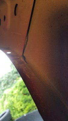

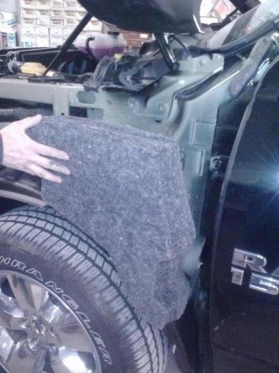

Do you have any pictures of it? Is that by the doors?My fender has rust bubbles on it now and the inner fender well was always removed each season and fluid film was applied. Rest of the underneath looks good, fender rusted in the area where the shipping foam was on the inside.

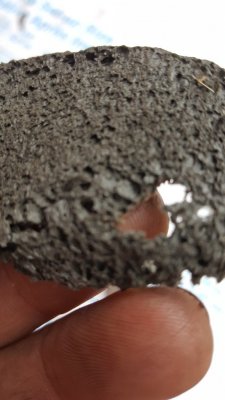

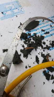

Lol so they didn't learn from the 3rd gens what it's a bad idea to put foam in the rear wheel wells?theres a piece of loose foam in rear wheel inner support bracket.. my 16 and 19 classic both had it...easy to remove with air gun and something flat to dig it out...i posted couple pics in older thread.. seen a few 4th gens around southern ont with rust on rear box above wheels.
yea.. i got some pics of it ...just dont know how to re post them...Lol so they didn't learn from the 3rd gens what it's a bad idea to put foam in the rear wheel wells?
Wow nothing like putting a sponge in a rust prone area........
