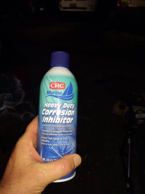

I added CRC Heavy Duty Rust Inhibitor on all areas where fluid Film might experience heat or rock hits. The front inner fender area at rockers and along the bottom of the rockers where the factory spot welds are and into the gaps as seen from below.
I also coated the rear exhaust to near the tips with it (Cosmoline). I definitely recommend wearing a respirator doing this please. And do not spray the CRC while smoking or anything hot/energized nearby. I still have some time before the salt. But they use slurry on the dirt road I live on to reduce dust apparently.. and my M35A2 has seen some serious onset as a result.IMG_20200907_011458227.jpg IMG_20200906_221944039.jpg Thank You Hemi395 for starting the thread and everyone here, all of your collective work. I joined this forum after seeing your posts. Just like you I hate rust.

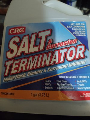

I forgot to mention, I used CRC SX128 (Salt Terminator) through my Pressure Washer on the Truck and let it dry for 24 hours before Fluid Film application.
If like Me you are on a well make sure to bypass your Water Softener and run hoses out of salt first.

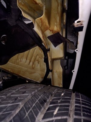

I also used the can red tips and shot FF inside all four fender flares. It is wicking nicely around the bolts.
Just ordered 3 more Gallons to hit the Deuce as I am sure it will gobble it up.
I also coated the rear exhaust to near the tips with it (Cosmoline). I definitely recommend wearing a respirator doing this please. And do not spray the CRC while smoking or anything hot/energized nearby. I still have some time before the salt. But they use slurry on the dirt road I live on to reduce dust apparently.. and my M35A2 has seen some serious onset as a result.View attachment 221272 View attachment 221271 Thank You Hemi395 for starting the thread and everyone here, all of your collective work. I joined this forum after seeing your posts. Just like you I hate rust.
You're welcome[emoji106]
Yeah the CRC/Amsoil HD Metal Protector are great products for places that get sprayed with water often because they resist wash off. They are a waxy cosmoline based product and form a semi permanent coating. I used Amsoil HD MP on the caps of my new ujoints so they won't rust and will make for an easy replacement next time. Just gotta let it dry overnight and it stays put even on a spinning driveshaft.
They only thing I would do is check it periodically to make sure it hasn't deteriorated or cracked with age...
