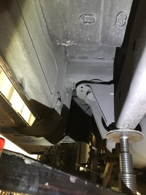

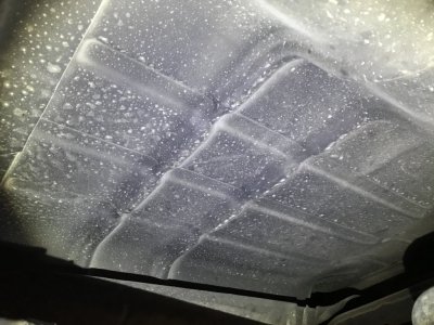

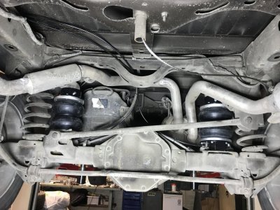

Just whant to show how good the a truck can look after 3 years when protected properly.
37.500 miles over 3 years and let's say half that on salty roads here in Sweden.
Took some pics when I installed BOSS air bags in the rear.
Will go in soon for a checkup and refill the protection in some spots.
But it's not cheep, initial cost is around 1.200USD and "refill" is around 430USD
But I plan of keeping this one for a while :)
