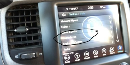

Hard to see the picture of what I'm talking about but I've seen a couple guys with UAQS able to see their auxillary switches on the radio but I've never been able to. My truck is a 17' with the added UAQ for an 18' Ram and I already have the auxillary switches through commercial settings on my 7" EVIC. Any setting I might be missing or any ideas?3b96b5ec3b264eec31d7f11796b17c6b.jpg

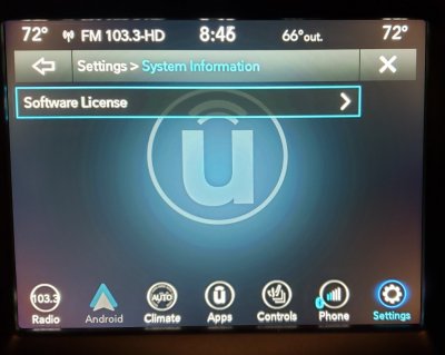

I'm trying to figure out my current software version but all I see under System Info is this:

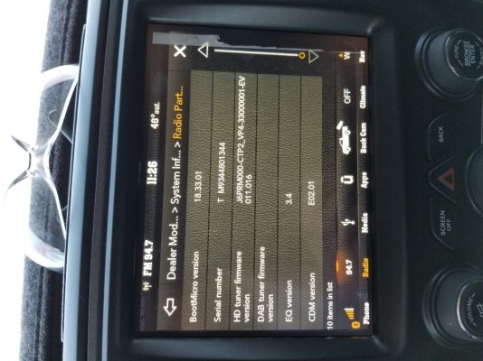

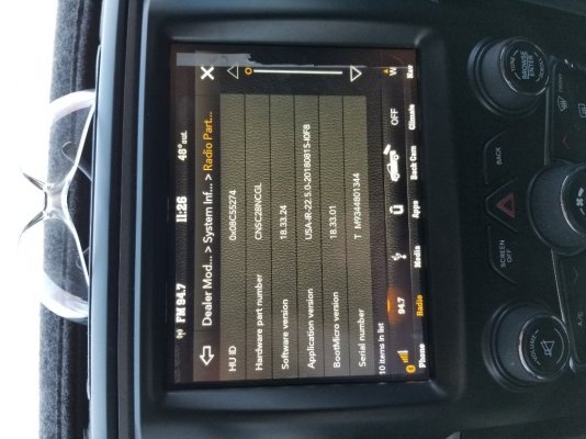

I am trying to see if there has been a software update for my 2018 Ram UAQ radio that I have installed in my 2017 Ram 2500. The only issue I have with the radio is the common problem where the text message notifications & the voice recognition volume are very loud and when you try to lower the volume it reverts back to the same volume. My radio was bought brand new so I'm nervous to brick it but was wondering how I can even update it since my truck didn't come factory with it but the radio was brand new when I installed it. I'll add a picture of what version it's running, I've never updated it as I don't know how to or where I could get an update without being able to use my Vin since it's not factory. f76ed79df5dcd99c19489b5eb6b291fd.jpg13ae5fee092ca61803cb12681dd77b6b.jpg

@Mpgrimm2 's firmware thread has version 22.6 for your radio. In two UASs I flashed, the upgrade to 22.6 fixed the notifications volume.
