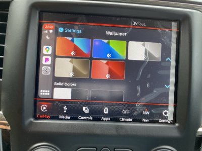

Still trying to see if there are any settings I can change in the BCM that will not cause any ill side effects to enable different theme options on my 18' Ram UAQ. I tried changing several special package options & setting both the same with no luck. a1d5061ebfe183ebfe100999bc82e83a.jpg
