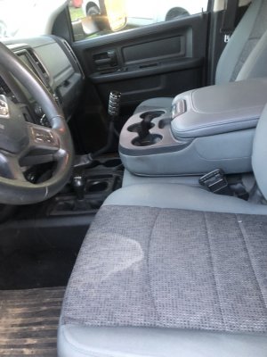

bought the center jumpseat
From laq out of a 2019
That had a UAS so I got it with the hub and the updated insert
For 100 bucks
I read drilled all the mounting bolts and moved it back a half an inch and it clears the stick perfectly

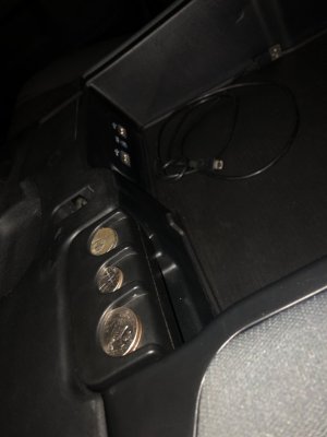

Make sure your 2018 jumpseat/usb hub is NOT constantly illuminated with the key off as it may drain the battery. This is a known issue with the console lid swap ... Depends on the year/config of your truck.... You may have to remove the hub illumination wire from a connector if it happens... +12v B+ on earlier trucks). See post 5 for issue with console lid.
M² Mods.
ManualCummins
May 3, 2016
222
102
Cummins 6.7
They cut the plug off so I had to swap over the wiring harness anyway lol
So the illumination wire is not connected pin 2
Even though I do notice that it does
Although it does seem to illuminate
But only when the key is on And the door is open
But thanks for the heads up anyway

So I did a little research and figured out if you hook the illumination pin
To the hot from the cigarette lighter
And put the fuse in spot number 91 everything will work As intended

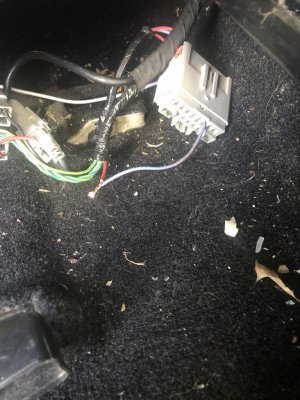

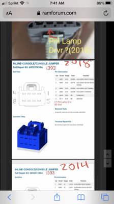

If you’re running a complete 18 wiring harness and consule or jump seat
You need to hook the orange wire
With a gray stripe to the purple wire underneath the driver seat as shown in the photo if u are runing a UAs/Uaq
However if you’re running an RA radio
You need to hook both the red wire and the orange wire To the purple
and then move the fuse to slot 91 from 90
Basically this uses the ignition on as the illumination feed
If you’re running just a replacement lid
You need to disconnect the orange wire
At the plug for the lid and run it to Switched hot to there Pin 7
If you just want the illumination to work and you’re running a hub adapter
you have to take the purple wire from the cigarette lighter plug by the hub and put it into Pin 2 of the hub adapter which will be empty
For somebody says about the wires just being twisted together that was only temporary to test it I soldered them now
