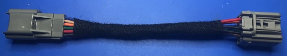

Hello I’m in the planning phase of upgrading to a 4C UCQ.
I have a Canadian 2017 1500 Ram Sport with factory 8.4 RA4, backup camera, auto hvac, dual hvac, 7 speed fan, heated seats and heated steering wheel. I understand I need:
Radio UCQ 68331632AH
USB HUB 68328704AC
USB harness from mpgrimm2
I’m hoping to source radio and hub from a salvage yard.
Will all the current hard, soft buttons and mic work with new UCQ or I need more modules/harness?
Thank you this forum/members are awesome

You did some reading & have it correct for your truck setup (thanks for the detailed info which covers everything I would have asked) ...
Swap the radio (need unlock code), Swap the hub and plug in the adapter harness and your all set. Nothing to program.

Tks for the quick reply, what’s the process to procure the USB Hub harness form you?
Mpgrimm2
Supporting Vendor Navy Badge
Mar 30, 2014
6,588
5,202
SC
2022 Ram 1500 (5th Gen)
5.7L
I'm getting ready to step out on vacation, but my M2 Mods partner @DeereGuy has these available though his KaodTech site he setup for his projects...
RAM 4C (UAS/UAQ) Media Hub Adapter Harness - $40 Purchase Here
