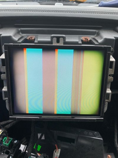

Left the ACQ screen in overnight and now this morning a bunch of vertical lines. I have looked at the LCD ribbon cables and PCB and they appear ok. Looks like the LCD/PCB is defective. I have not tried a software update yet. I will send this unit back.
Did you try reseating the cables since it's already been opened?

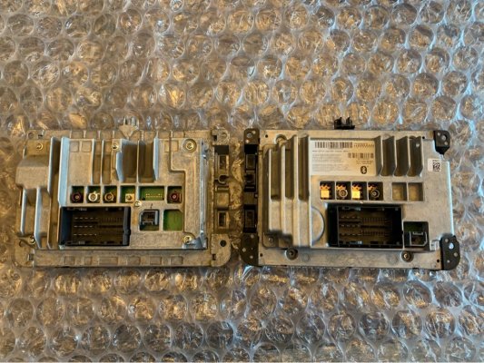

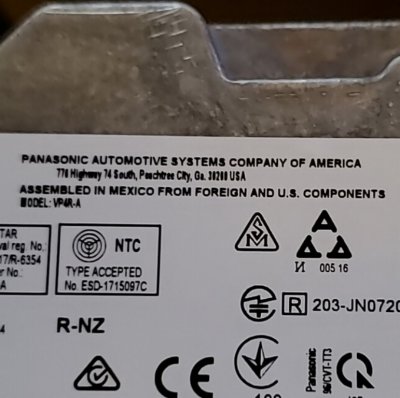

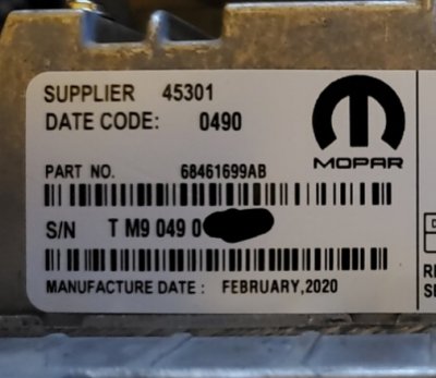

Finally put an 8.4 in my truck. I got it from a 2020 classic. Based on the build sheet for the VIN I thought it was going to be a UAQ. Turns out its a VP4R-A??? Part number is 68461699AB. I googled the part number but didn't come up with anything. Seems to be working, I had a little scare when the backup camera didn't work at first. It took about 3 or 4 key cycles before it came on. XM was working at first but it went back to demo mode after a couple of hours. Has anyone else ran across one of these?20201101_161147.jpg 20201101_161726.jpg 20201101_161633.jpg

Finally put an 8.4 in my truck. I got it from a 2020 classic. Based on the build sheet for the VIN I thought it was going to be a UAQ. Turns out its a VP4R-A??? Part number is 68461699AB. I googled the part number but didn't come up with anything. Seems to be working, I had a little scare when the backup camera didn't work at first. It took about 3 or 4 key cycles before it came on. XM was working at first but it went back to demo mode after a couple of hours. Has anyone else ran across one of these?View attachment 226294 View attachment 226295 View attachment 226296
Can you PM me the serial number? I want to check something.
I highly doubt that radio is out of a 2020 Ram Classic.... Likely a Cherokee/compass based on that JR 30.24.x sw application version.
M² Mods.
All I know is I used the vin from the doner truck and the radio serial number to get the unlock code from my local dealer.
