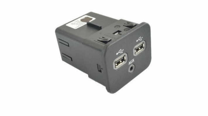

Is there a USB hub option that would fit the Jumpseat console that has 2 USB connections (that both would work for AA/Carplay)?
I am currently using the Chrysler 200 hub but have 2 phones and depending on what I am doing I have to open the console and swap the cords around. Would love to be able to leave the cords plugged in and just connect which phone I want to use. I have the phone end of the cords run out around the cup holder trim so I can get to that easy enough
Thanks,
I thought the Chrysler 200 hub had two USB ports? I went with a 5th gen media hub because the Chrysler one was on back order. Still working on my install though. And mines going in a 2016 center console.

I thought the Chrysler 200 hub had two USB ports? I went with a 5th gen media hub because the Chrysler one was in back order. Still working on my install though. And mines going in a 2016 center console.
Yes the Chrysler 200 xxxxx703Aa has 2 active ports... So I'm confused by that as well.
Sorry, I have the "Compass" hub. I thought I bought the 200 version
So will both connections work on the 200 hub for AA/CP?

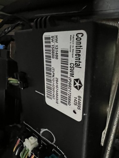

So still no luck with the 4c retrofit harness they sent me, i even got a brand new head unit sent from them, and still no luck, tried it with and without the harness. Heated/cooled seats appear on screen but still greyed out. What is the part number for the 2018 module to swap out?
I still can't find the @Roman217 's reference, but I'm 99% sure it's CSWM Pn: 68217268af
Yes they will as long as you find the one mentioned in post 5 vs base model 200 hub which doesn't work at (I've tried it). The xxxx703AA Chrysler 200 hub has been on National Backorder since November of last year with no ETA. Have to find a used one from salvage vehicle.
The Dual USB Port 2018 ram hub mentioned in post 1 & 5 also has both ports active.

The BCM is actually responsible for the this one. Starting in 2015, they changed what CAN message is sent by the BCM for engine RPM. The UAQ radios look for a different message than the previous radios.
The radio looks for the RPM message to check whether the engine is running and only allows the heated/vented seats to be toggled while the engine is on.
Thank You for the reply! So with the engine running shouldn’t it see an RPM signal and let it work? Are there any solutions to make this work? Also i will attach picture of cwsm module. Thanks.
You already have the newer PN seat module.
Your basically out of options because the 4c Seat Module isn't able to change the messages from your 2015 bcm to the correct messages the new radio is looking for.
(Thanks @Roman217 for the extra piece of the puzzle)
