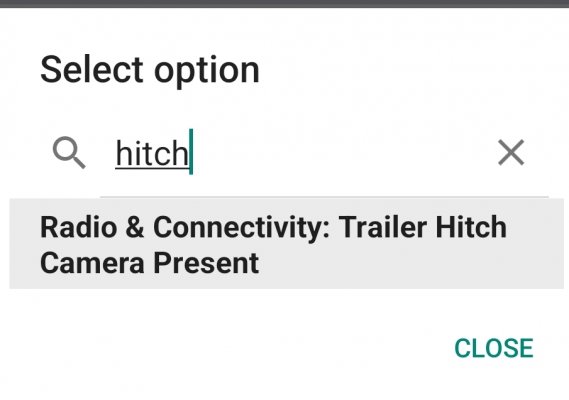

did the softkey for reverse camera come back for you? If not, you can enable it using Alfa.
Body computer
Car Configuration Change
Radio & Connectivity: Trailer Hitch Camera Present - yes
This enables the Radio Softkey/button

Thank you very much. It did not come back so I will try what you said with AlfaOBD. I was able to set my cargo camera soft key though.

I just tried and that option is not there.
Try choosing a different BCM/powernet year... ie 16-17 or 2018 (it will still connect correctly)

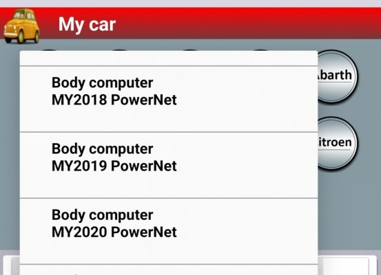

I tried MY 15 17 18, no option like that one. Mine is an early 2014.
I'm seeing it under the following powernets ... But I'm not actually connecting to any truck...
MY2018 powernet
MY2019 powernet
MY2020 powernet
MY2018 powernet
MY2019 powernet
MY2020 powernet
Yes, I do see it in the app. I don't know why I did not see it last night. I will try this at lunch.

Well I tried again at lunch and it did not matter which MY I selected Alfa always connected to MY14+ body computer and that setting was not listed.
