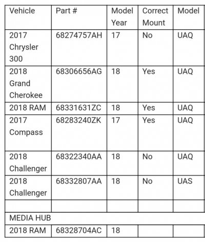

So I went to update to 18.14, and I got an error saying update not compatible with vehicle ???
Where did you get the update from?
What's the PN of your radio?
M² Mods.
Mpgrimm2
Supporting Vendor Navy Badge
Mar 30, 2014
6,589
5,204
SC
2022 Ram 1500 (5th Gen)
5.7L

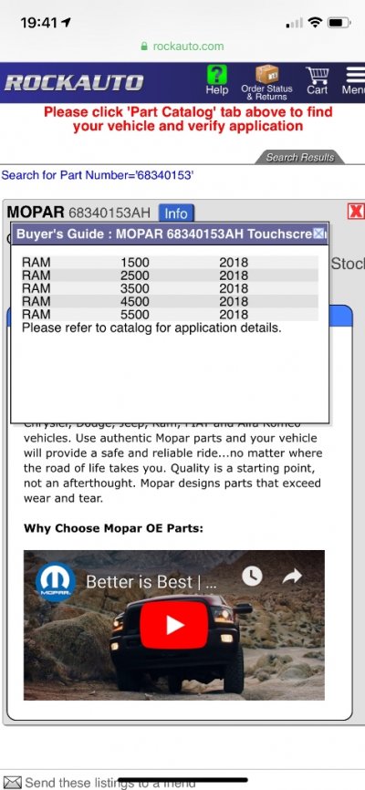

68340153aa
What vehicle is that out of? Not a ram.
Is it a UAQ or UAS radio?
The 18.14 fw (application version) file Deereguy and I have linked in the 13-18 8.4 Nav radio thread is for 18 UAQ radios. 9507979ca7f7c17e7c9b7d17817dc5a8.jpg

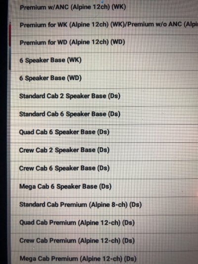

If you have the AlfaOBD, have to tried checking the current Cabin EQ Curve settings and seeing what the options are?
M² Mods.
Yes, I have both Android and Windows AlfaOBD. There are a ton of options (many for DS) and I wasn't thinking and tried to set a change before I saw what was current. So I went to the first Factory log that everyone suggested I copy to Google Drive and found that my RA1 regular cab was set to this?????????
Cabin Equalization Curve Number: Crew Cab Premium (Alpine 12-ch) (DS).
Any suggestions of what to try? Or just try all the DS ones?

Do you have a quad or a crew cab and do you have the alpine system.
I don’t know what the options are but if you have a crew without alpine. Find the setting with out the alpine 12ch.
Mine is
Cabin equalization curve number: Quad Cab 6 speaker base (DS)
You can always try my option then work your way through the options cause you never know which one will work lol

I have a regular cab 6 speakers, never had an Alpine. Upgraded from no Uconnect 4 times so far:
1.) RA1 Uconnect, perfect sound
2.) RA2 perfect sound
3.) UAS no rear speakers until it updated to 18.20 / 21.9.0 but had no microphone
4.) UAQ that's perfect except no rear speakers. 17.43.44 / 19.9.0 / 17.35

I believe he has a Regular cab. Not sure if he had the factory Alpine or stock 3.0 radio. (I doubt it should be set to the 12 speaker Alpine w/amp)

Try and find the option in Alfa for a Reg cab 6 speaker. Or try the quad cab 6 speaker.

That's what I would have thought about that setting but the line I put in with the Alpine 12 channel was a cut and paste of the factory BCM settings from the first Google Drive upload before I changed anything.
I'll go set it to the Quad cab 6 speaker and let it sleep for tonight.

It’s almost to the bottom of the options for cabin equalization curve number.
Try the standard cab 6 speaker base DS. You can always try the quad and crew if that option doesn’t work. Just stay with the options that say DS
The standard cab premium alpine 8 ch is another good option to try.

It’s possible that with the 3.0 and 5.0 they don’t exactly read the BCM for that exact option having a upgraded radio it pulls everything from the BCM. That’s my guess on why it was fine until you got the upgraded radio
