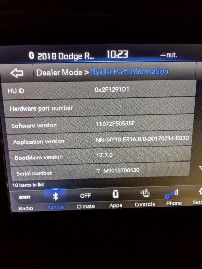

So i went outside i checked out my software version and whatnot, I'll attach the photo of this info. Playing with the radio some more found that NONE of the on screen climate control buttons work, i can only adjust temperature, fan speed, Auto mode with the physical buttons, I also found my rear defroster doesn't work. I push the physical button and it blinks a few times then shuts off much like the heated seats.
I understood going into this that certain buttons might not work on the radio, but the physical buttons should still work. That's not the case for me right now and i'm not sure how to fix this.
All these features all came stock with the truck, I used alfaOBD to double check, all these items are turned on in the BCM.

Did you replace the HVAC module? If not. That is your problem. Look a few post up to my reply to your first post

I did see your post about the HVAC module and i'll most likely end up getting an 18, but what i'm unclear on is if the HVAC module will correct my heated seats & defroster issue, those are my primary concerns ATM.

The HVAC modules is a “computer” that controls all heating. Ventilation and air conditioning systems in your vehicle.
