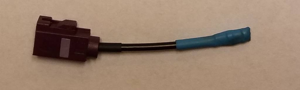

If you are using a 13-17 RAx 8.4 radio in a 13-17 truck you can install a Cell Bypass Plug onto the cellular antenna input at the radio to get rid of the 911/cell system error message you'd get by not having the sharkfin antenna (sxm/GPS & cellular ... mustard & violet connectors) where the flat puck only has the single sxm/GPS( mustard connector).
The 2018 UAx radio doesn't even seen to care/check the cellular connection so no bypass plug is needed.

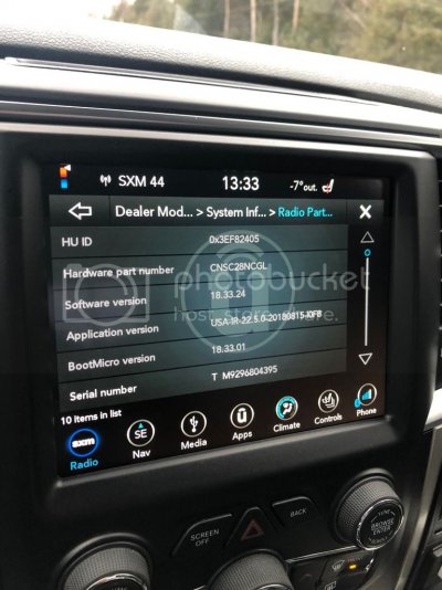

Looking for help with a few issues following my RA2 to UAQ swap. The number 1 is a big problem for me as I'm a contractor and I'm always on the phone. If it can't be resolved I'm open to trading for a RA4 radio+cash. Thanks in advance, fellas!
What I've noticed so far:
1. Handsfree sound quality is poor and I can barely hear the caller. This is with the volume turned up to the max on both the radio and the phone (iphone 8 plus)
2. Backup camera quality. The picture is fuzzy and has a bit of static
3. HVAC heat controls are unpredictable, the screen shows full heat but the air is still cold. If I keep pressing the heat UP button on the bezel it works.
Note, I did the install with the battery connected. I'll disconnect the battery tomorrow to see if it helps with anything.

The heat problem has been answered in this very thread. You have to use AlfaOBD to change the BCM first to a dual zone automatic climate control and then to a single zone automatic climate.
The camera and phone stuff I don’t know about.

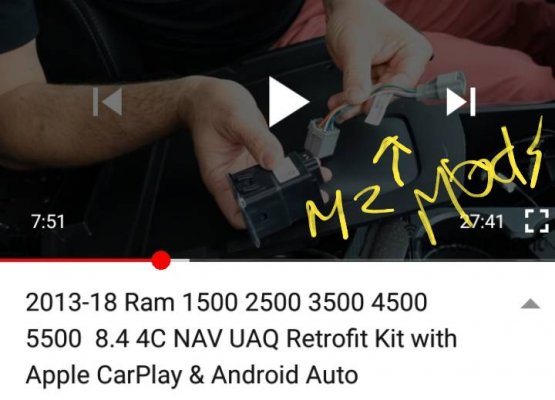

Infotainment has posted a new install video on the UAS/UAQ upgrade they are selling and I find it interesting that they make no mention whatsoever of upgrading the HVAC module to the 2018 one. I wonder if they are altering something in the programing of the radio to avoid the need or if they are just ignoring it...

They also didn't mention all the stuff you need to do if upgrading from a 5" radio in a 2500-3500 with the different cabling, fan resistors, etc even though the beginning of the video said 1500-5500. I guess that video is only applicable if you already had the 8.4

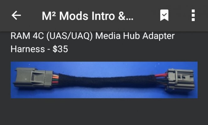

I see at 7:48 on the video Infotainment finally copied our UAx USB hub adapter cable vs the one they had originally with no aux support.
I'll add this... They do a good job of supporting the complete kits they sell. One stop shopping.
Their video ...
Ours...
