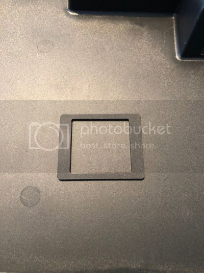

So what your saying is I just gotta want it more lol I'll try again when the weather gets up over 25 degrees.
If you use a plastic trim removal tool it will pop right off but I understand not wanting to get this done in the cold...I too have no garage.
Yea using my plastic pry tool helped a bunch, here's the part number:
Also it's Revision A

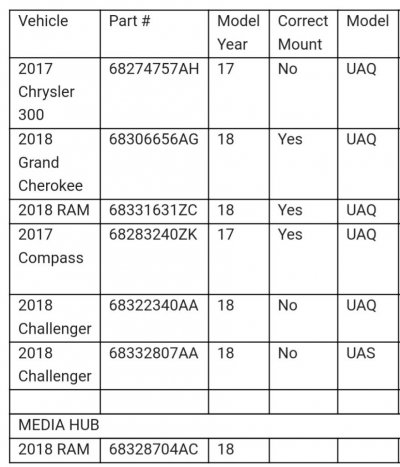

So I added the new 2018 8.4 with Navigation into my 2017 1500, over the Christmas. MPGrimm wanted me to let you guys and girls know how it went. It was a very easy install and I have had zero issues with the radio. Sound and functionality throughout is great, with no glitches. The only thing I haven't gotten absolutely perfect yet is the ATC but that is because I am still lacking the humidity sensor. The radio is a 22.5 which MPGrimm said was the latest upgrade. I was able to call and get my Sirius XM working first night and they gave me another two months free. The radio was brand new and MPGrimm made the conversion harness. It was extremely well made and he really was good about answering questions. I have had quite a few! I also did the Speedometer upgrade which is worth every penny spent. It took all of 15 minutes to install. Over all the biggest thing I have learned through the upgrades is; that even though the body styles are the same from 13-18 the wiring is not. So there are still limitations on what you can do. I purchased AlphaOBD and that has helped as well through out this process, its a small price to pay for what it does. If you guys and girls have any questions please feel free to ask.

Ok I’ve read this thread and now thinking of doing this mod but getting confused about the hvac system and backup camera. I have a 2016 1500 Laramie with 8.4 auto dual climate control... do I need anything other than the headunit, hub, and harness??

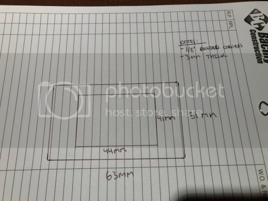

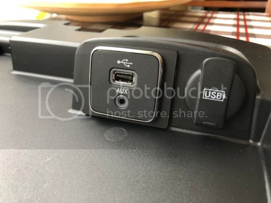

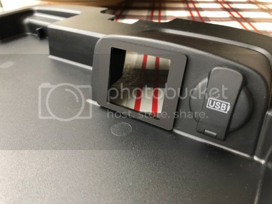

The texture with 3D printing would look back in my opinion. I'm looking to have a sheet of PVC cut to size. I'll send pictures once it's done.
Here's an idea for anyone using the USB hub from the compass:
The measurements I took using my caliper. Note, you'll require to make alterations to the USB hub and widen the original hub opening.

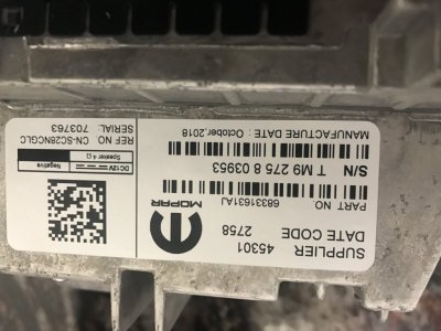

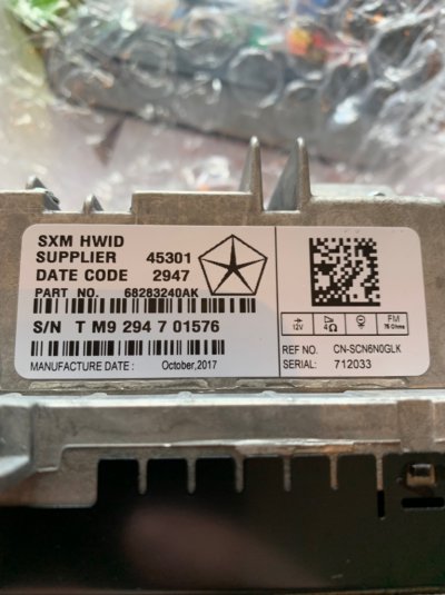

So I'm needing some help from the collective. My truck is a 2014 1500 Limited with the 8.4AN that works perfectly. I'm having the same issue with my second attempt at installing a UAQ radio. Both the UAQ radios I've installed boot up and runs for 45-60 seconds and then restart. I read about an update in February of 2018 that resulted in this exact same thing happening that was related to Travel Link. So I used AlfaOBD to change the SDAR Travel Link Feature Present: to NO. Still reboots. I disconnected the cellular antenna connector from the radio. Still reboots. I disconnected the USB hub (The new RAM dual USB with the Adapter cable from M2Mods). Still reboots. I haven't tried to disconnect the Sat/GPS antenna to see if that makes a difference. Sirius works, CarPlay works, HD FM Radio works, Paired with my phone just fine. Navigation starts loading, but it doesn't get loaded before the radio reboots. The radio has a purple sticker showing that it's a version 18.7. According the the UConnect website when I enter the VIN from the vehicle it came out of it's up to date. Anyone have suggestions?
Go into dealer mode and tell us what the application version is (not fw version).
(Driver side) hot +cold + front Defrost for 6-10secs
The UAx will likely need to be on application version 18.14 or higher.
What is the PN of the radio?
( 68331631Ax ? (UAQ) )
M² Mods.

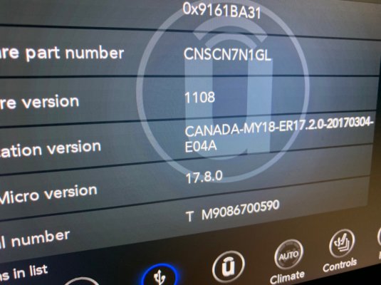

So I think this might shed some light on the issue:

Yeah. That's a bit off from what you need.
M² Mods.
So is the issue that it’s a Canadian radio or that it’s out of a Compass or both? I picked it up cheap so I’m pretty sure that I can get my money back out of it. Not sure how to tell from VIN when a car is Canadian vs US.

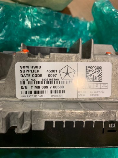

Crazy thing is that I had the same rebooting issue with this radio too:
Between this and my cargo camera install I’m getting my ass kicked.
