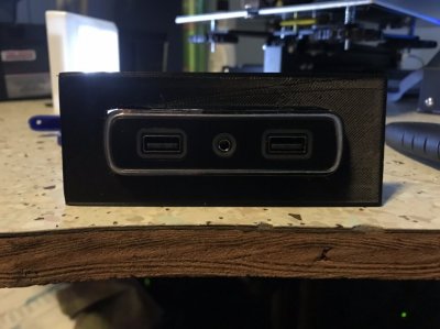

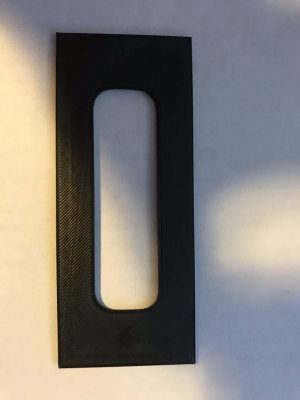

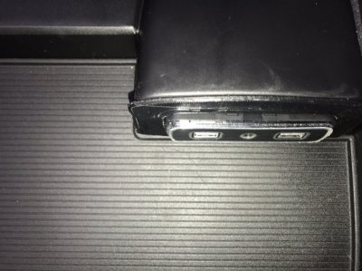

Looking for some help. I am trying to 3D print a face plate to cover the hole I cut for the media hub. The first picture is my first attempt at printing it and as you can see I don’t have the curve in the top and the middle opening is a bit to small. I started to dremel it out and the second pic is the finished product for the media hub slot. It is rough and doesn’t look that good.
Now to the help part. I am new to 3D printing and rendering 3D objects so all I have is a tape measure and it makes it a little hard to get exact measurements. Can anyone take some good measurements and make a little drawing so i can render it into a 3D object? In millimeter would be awesome.
Thanks
View attachment 153906View attachment 153907
Thanks
I wish you luck with this. I don't have a UAx radio, but I've done other 3D printed parts for our trucks and I offered to do this one. I've had 3 different people volunteer to get me the measurements over the last several months (one even offered to mail me a hub to take my own), none have followed through on their offer.
I'd suggest getting yourself an inexpensive digital micrometer and taking your own measurements.
https://www.amazon.com/s/ref=nb_sb_noss_2?url=search-alias=aps&field-keywords=digital+micrometer
-K
-K

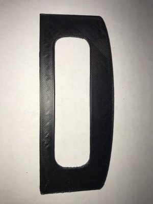

Thanks for the advice.
I printed out a 15cm ruler and a set of calipers. I reworked the outside dimensions and did a 2d print and it fits pretty good. I will work on the knock out for the actual media later today. Hopefully I can get some pictures up after the first 3d print is done.

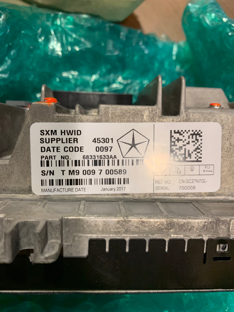

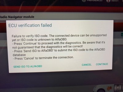

So I'm messing around with this right now. I looked at the radio module in AlphaOBD and it brings up an error message when I connect to the radio. I tried to update the firmware, but no luck so far. The USB hub will read from a thumb drive one time, but it doesn't continue to work when the radio reboots. I noticed this when I was checking to see if the radio would play mp3s off of the thumb drive. It worked the very first time, but after it reboots it doesn't see the drive any longer. I'm installing the update on a different thumb drive to see if that will make a difference. I'm just about out of things to try on my end. Sent an email and left voice mails at NavRepair.com to see if they thought they might be able to do something, but haven't heard back and don't expect to since it's been 4 days. Here are the logs from my original radio and the UAQ radio. Weird how the VIN is populated in the UAQ but not in my orginal:
Original RA4 Radio
Tested device: Radio Navigator Module
2019/01/30 12:24:04.544
DEVICE INFO:
Fiat drawing number:
VIN:
Hardware number:
Hardware version: FF
Software number: 17.11.17.00
Software version: 8971
Homologation number:
ISO code: 2020202020
VIN:
ECU serial number: T00BE030XXXXXX
ECU Part Number: 68224525AG
Hardware number: 0002604450
Hardware Supplier Identification: Harman / Becker
Software Logical Block Supplier Identification: Harman / Becker
New UAQ Radio
2019/02/01 14:38:31.235
DEVICE INFO:
VIN: 1C6RR7PT8ES2XXXXX
Hardware number: �����������
Hardware version: 11
Software number: 110800
Software version: 1108
ISO code: FFFFFFFFFF
ECU serial number: T M9086XXXXX
ECU Part Number: 68332802AA
Hardware number: CNSCN7N1GL
Hardware Supplier Identification: Panasonic
Software Logical Block Supplier Identification: Panasonic
Ryan Wehr

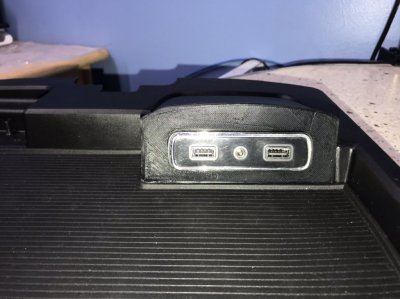

This is revision 4 of the media hub face plate.
I spent about 5 minutes with the dremel on the hole where the media hub goes and it popped right in. I still need to clean the top edge as I could not get the angle to match as well as I would have liked. Then I just need to smooth out the piece and it should be good.

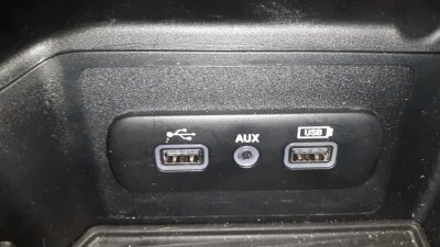

So, I had a similar issue on an older RA3. I bypassed the hub altogether by plugging the USB directly into the radio with this adapter:
USB Host Cable mini B male to USB... https://www.amazon.com/dp/B00JK1OFOM?ref=ppx_pop_mob_ap_share
It updated immediately and the hub worked normally afterwards. I suspect it was a driver issue. Your's sounds a little different, but a similar solution may work...
