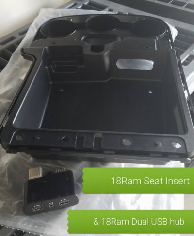

Alright folks, finally got the 2018 jumpseat insert and took a break from unpacking after moving to get the 18 Ram Dual USB port hub installed to use with the 18 Ram UAQ radio that's already in my 13 Ram (replaced the UAS).
Parts:
68328704AC - 18 Ram MEDIA HUB: $99
https://parts.allmoparparts.com/oem-parts/mopar-media-hub-hub-68328704ac
68376066AA - 18 Ram Jumpseat Lid/Storage Bin (black) : $95
https://parts.allmoparparts.com/oem-parts/mopar-lid-storage-bin-68376066aa
Pictures:

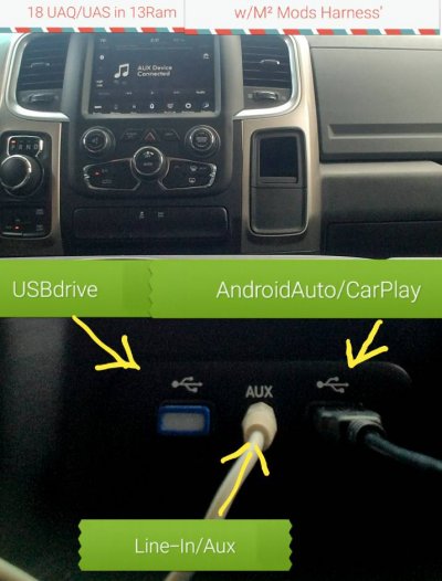

Noteworthy EDIT:
Without changing the BCM setting to enable the 2nd USB hub port, I can confirm the following ...
- Left USB port works for both USB Media/thumbdrive and Android Auto (& CarPlay likely).
- Right USB port works with Android Auto (& CarPlay likely), but not for USB media.
Install videos (3):
Part 1 -
Part 2 -
Part 3 -

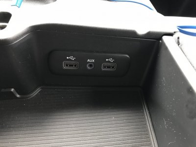

Guido2112
Jan 9, 2014
106
91
I got the new hub and insert installed. Both USB ports work fine, but can't seem to get the aux cable to work (may just be my cable)...any thoughts?
DeereGuy
DeereGuy
Nov 9, 2016
623
577
Pittsburgh, PA
Last I heard their media hub harness doesn’t have the aux wiring in it. It’s just power and ground to make the hub work.
Guido2112
Jan 9, 2014
106
91
ugh...oh well, never use it much in my Challenger so I probably won't need it in my truck.
