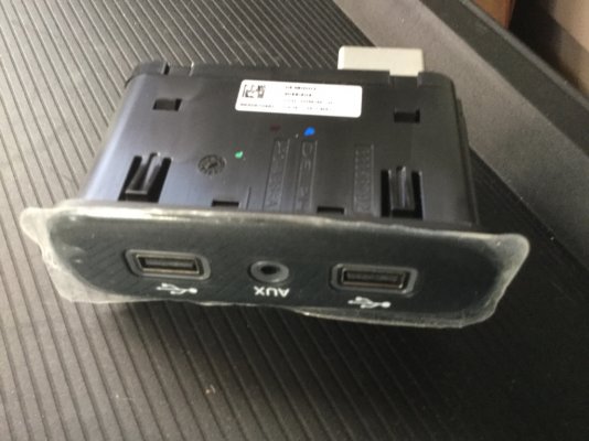

Purchased Form Infotainment 6833163AH UAQ. Installation was not too difficult but they sent me the wrong media hub. When I powered UAQ up I was finally able to see the Sirius icon appear. Every aspect of the unit appears to be working except one big problem. I get no audio from any sources, fm, am , Sirius , Bluetooth thru my iPhone , no a squeak. Called Infotainment and they were surprised it did not work and did not offer any real solutions. Can someone help me out or will I have to return the unit maybe get another one or just get a refund, Thanks any help would be appreciated as I really like the look of this unit

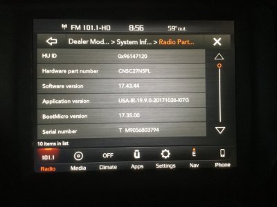

Can you go into dealer mode (It’s either temp up and temp down together for a few seconds or temp up, temp down, and front defrost together for a few seconds) and then go into radio part information menu and post a picture? I’m looking for the application version.
What hub did they send you?

Here’s the hub they sent

Radio Parts info is here

My opinion is it’s the radio. I’d exchange it for another one and see what happens. The firmware version on it is the same one me and a lot of other people has.
