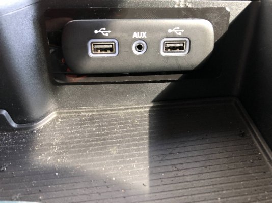

I really like that. Is the one you made matte? Also, do both USB ports fully function with the unit?
Sent from my BBB100-1 using Tapatalk
The one in the picture has a glossy finish. and yes both USB ports work.

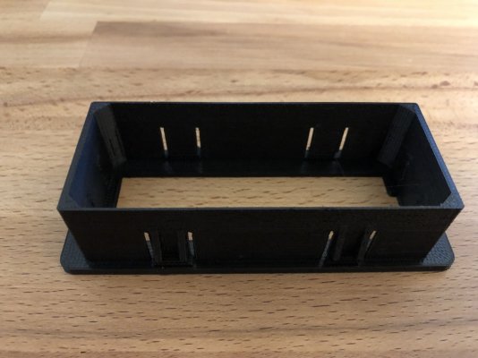

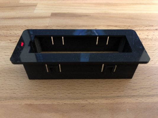

So for anyone who wants to run the Fullsize Hub and not the Compass one, here is what the adapter I whipped up looks like. Surface finish can be either matte or glossy.
That looks like it would work pretty well. I've been looking for a solution like that.
Did you have the 12v receptacle in your console prior to switching out the hub? I'm considering rerouting that 12v to the lower outside area by the rear HVAC vents
I did have the 12v, to use the adapter, you remove the old hub, then cut across to the far edge of the 12v plug and the adapter clips in.
That's great, I was planning to convert that 12v into USB power anyway.
Let me know if you are interested/available in selling me one of your adapters!

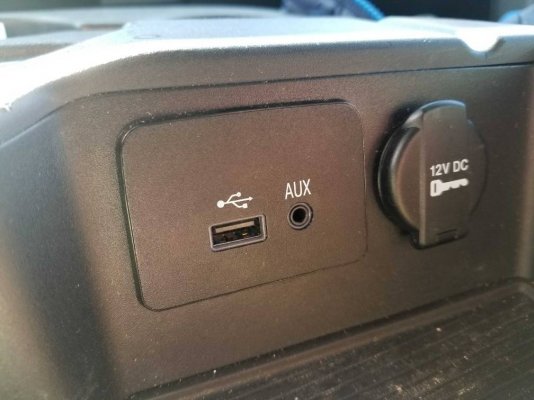

Forgive my ignorance here...Right now I have the Compass hub with only 1 USB port. Can I get the full-size hub and get 2 usb ports to work?
Plug and play or will I need to wire anything else????
Plug and play.
