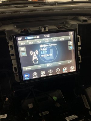

Having some issues upon installing a 2018 UAQ in my 2014. Guessing this could be due to it being a Canadian truck and the radio is for a US vehicle? I only had 4 wires on the back of my original 2014 8.4: white, grey, yellow, and the main harness.
- No sound, either with radio, phone Bluetooth, or CarPlay (which loaded up fine)
- no satellite radio option
- I installed the infotainment kit for the heated/cooled seats and heated steering wheel....seats function fine but heated steering wheel won’t turn on
- built in GPS won’t locate
Am I hooped? Do I need a Canadian radio?

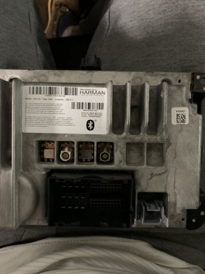

Here’s the back of my original 2014 8.4 radio
*something interesting - I pushed the SOS app and sound came through dash speakers saying it’s not available.

Pulled the fuse near brake booster...got sound and AM/FM works, but still no XM, heated steering wheel won’t turn on, onboard GPS won’t locate.
rocket61
Sep 25, 2019
21
New York
Also don't seem to have the "controls" icon for heated/cooled seats and wheel, although the hard buttons on the console work and display a message on the screen when turned on/off.
no back up cam either

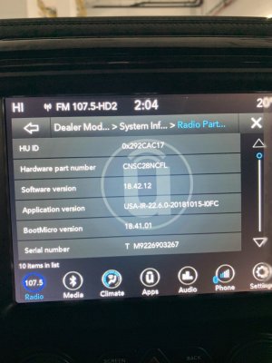

first reset got XM, backup cam, and seat control icons. Built in NAV still won’t pick up a signal - hoping it will on overnight sleep.

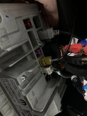

It sounds like no GPS signal. One thing you might want to check is the tiny little pin in the center of the GPS connector on the back of the radio. It is small so you may need a magnifying glass. I had one from a salvage vehicle and somehow they bent the pin for the cellular modem so it shorted to side of the connector so the radio would always show "take to the dealer for repair" upon start up. The connector went on fine and everything just the error on start up. I carefully straightened the pin with a tiny screwdriver and it works fine now.

so update on the install, truck slept overnight and this morning the onboard GPS connected and everything appears to be working. XM is active, must be a free trial or something because I didn't have a subscription on my old radio.

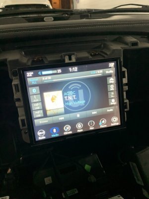

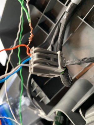

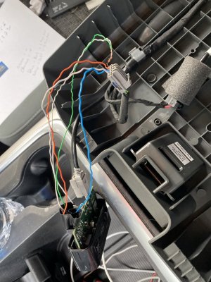

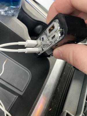

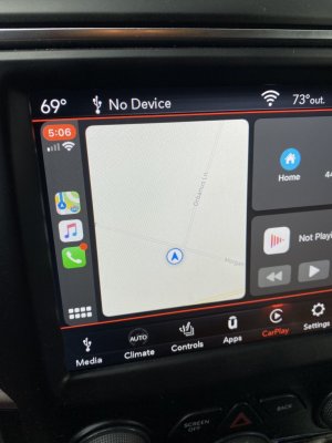

Update on the 2019 USB Media Hub.
It appears to work fine. I still don't have my conversation harness yet so I wasn't able to plug it in and make it look nice. However I was able to rig up a temporary harness and test it. CarPlay works on the left USB ports (both A and C). IMG_2308.JPGIMG_5527.JPGIMG_8589.JPGIMG_9828.JPG
