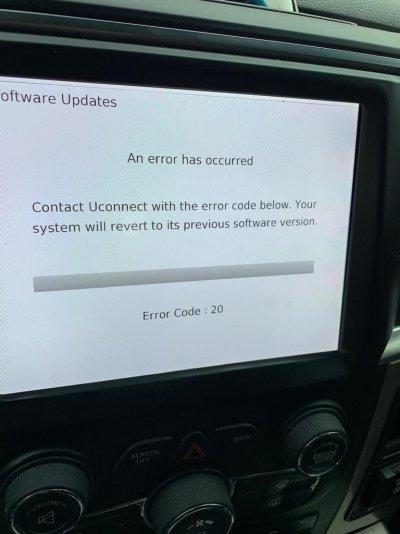

Does anyone have any idea what to do with this or did I just brick it by trying to update it? I got the file from the dealer to 22.6. It sat on this screen for about 10 mins. Then tried to reboot the. Stayed stuck on this screen.
When this happened with my RA4 I just left the update in and walked away. After a day or so the radio booted up successfully and installed the update.
Do you know what part/section the radio failed on?
I don't know where it failed. It intially said 35 mins for the update. I came back 5 mins later and it had that failed screen and said it would revert to the previous software update, it stated on that screen for a few mins then said update failed again and gave the Error 20 Code. I took it to Dodge and called Uconnect and they both made it seem like I was SOL.
Two questions, have you let it sit with the update in for any amount of time (like 48 hours) and are you still within the return window? Sometimes it's best to just cut your losses while you can (a lesson I find hard to follow)...

I unplugged it and removed it from the truck because it stayed on that screen even with the truck off. I am still in the return window so was thinking of just doing that.
Understandable. If you have the time, just leave it in with the update USB and see if it revives itself. It seems on the older units, if one section failed it would keep retrying for a long time but it eventually timed out and booted up again. I know these are different hardware but the firmware software design may have been created with the same failsafes...
