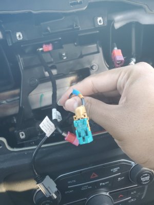

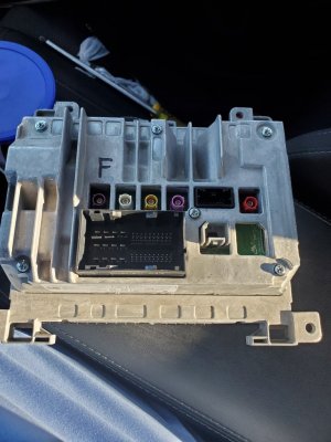

Hello guys i need some help i was moving to fast and unplugged the connectors from back of radio without seeing what goes where. Now my Sirrius XM just says contact dealer and my Navigation just says looking for gps signal. I have a teal greenish connector left over any ideas to where it goes to get these two back working see attached pics.

It goes on the mustard yellow plug (SXM/GPS antenna).

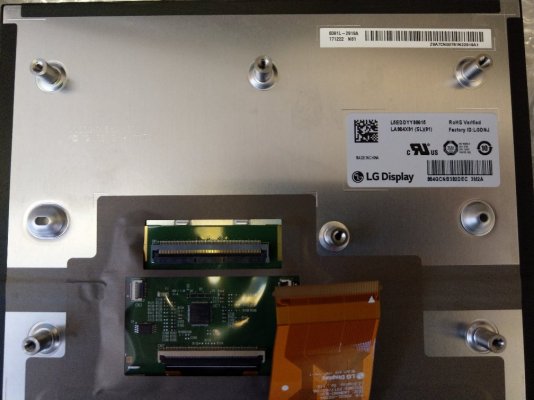

Adding to my earlier post, I've found that both the LA084X01-SL02 and LA084X01-SL01 screens work in a 2019 UAS radio. In addition, @Joe Gomez opened up his 2018 UAQ and identified the screen installed as a LA084X01-SL01.
I'm currently testing the LA084X01-SL01 screen in my 2019 UAS to see if it corrects the ghost touch/unresponsive touch issues I am having.
One note, the Aforementioned link on eBay states it is for a LA084X01-SL02 but I received a LA084X01-SL01. Both work but I'll be returning the screen unless they offer me a partial refund as there are cheaper listings for the SL01 screens (some evaluation only models are selling for as low as $70).
I'll post up again for anyone following who may be trying to solve the phantom touch issues with results.
Edit: Screen received below in like new condition with 5 layers of bubble wrap and shipped via Air Mail from China. It took 14 days to deliver.01928867ca0249d3584d9234bd89d304.jpg
Ok, screen replacement appears to have corrected all touchscreen unresponsive/ghost touches.
I reached out to the seller of the screen about the incorrect description for the item they sold me. They were pretty honest and let me know that their profit margin is pretty slim on these but they were willing to offer me a 1 year warranty if the screen stopped working for any reason. I think that's reasonable considering the cheaper SL01 screens appear to be salesmen/evaluation samples (not meant for resale).
In addition, I don't believe my compass issue can be resolved without a firmware update fix. The UAS appears to block the compass heading from going to the EVIC at startup. I can get it to work temporarily by plugging in an RA4 to get the heading back in the EVIC. After that installing the UAS while the vehicle is running let's the radio be on and have the Compass heading displayed properly in the EVIC but as soon as you restart the truck the UAS blocks the heading again. I'm wondering if not having the additional customer menu settings in the radio and/or EVIC is actually what's happening here. I think maybe the radio has the "display compass heading" set to "no" but I don't have access to the menu option.
Currently my fix is to hide the "--" by having something else displayed so I don't see it.
If anyone can think of anything I'm open to ideas.
Ok so i connected it to the yellow plug power cycled it. Still is saying looking for GPS and no XM signal contact dealer. This is weird i wonder if my U. Connect is taking a dump.
