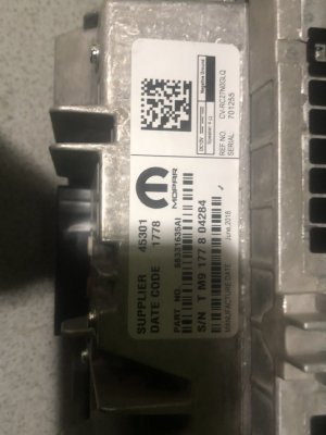

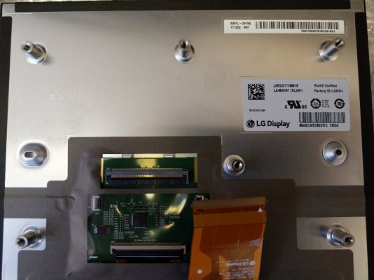

I found a great price on replacement screens...
https://www.ebay.com/i/183864179347...pCXpWRLpoaxTlJ6wokp85f9JEDrCmWhMaAsuoEALw_wcB
I have mine open right now and it looks right. Part number to search is LA084X01-SL02
Adding to my earlier post, I've found that both the LA084X01-SL02 and LA084X01-SL01 screens work in a 2019 UAS radio. In addition, @Joe Gomez opened up his 2018 UAQ and identified the screen installed as a LA084X01-SL01.
I'm currently testing the LA084X01-SL01 screen in my 2019 UAS to see if it corrects the ghost touch/unresponsive touch issues I am having.
One note, the Aforementioned link on eBay states it is for a LA084X01-SL02 but I received a LA084X01-SL01. Both work but I'll be returning the screen unless they offer me a partial refund as there are cheaper listings for the SL01 screens (some evaluation only models are selling for as low as $70).
I'll post up again for anyone following who may be trying to solve the phantom touch issues with results.
Edit: Screen received below in like new condition with 5 layers of bubble wrap and shipped via Air Mail from China. It took 14 days to deliver.01928867ca0249d3584d9234bd89d304.jpg

Fingers crossed, so far so good with the new replacement screen. I have yet to experience any errors with touch response. The only difference I could discern between the different part numbers is the SL01 screen has a slightly cooler color temperature than the SL02.

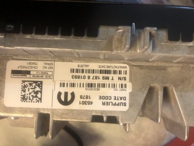

Does anyone know what the latest revision of the 68331631?? part number is? I was looking at the 68331631AE but on the moparcanada site they show that part as discontinued but it I still a valid part number when I check the US mopar site.
SitKneelBend
Moderator
Member Relations Specialist
Jan 8, 2015
11,004
7,717
St. Louis
3.6 Pentastar
68331631AK I believe...
