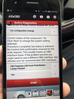

6855B7AB-37B5-4B33-A156-D1CCE455FE11.jpeg Here is what I get after I try.Yes I’m connected to the BCM. At least it says I am.

View attachment 200781 Here is what I get after I try.Yes I’m connected to the BCM. At least it says I am.
From your pic it doesn't look like you are connected to the obd2 reader. The bluetooth symbol is greyed out on your phone which means you are not connected. On alfaobd the home screen you have click the bluetooth icon and select your reader. Once connected select bcm, 2018 is now included in the last update a couple days ago, select connect then go to where you are. As mentioned above 18's need a security bypass cable.

So will I not need the security module bypass now because of the update or do I still need to get the bypass for the AlfaOBD to work?
As stated above, yes you still need the security bypass cable. Although you maybe able to connect to the bcm, it wouldn't allow you to make any changes.
Since I started using the app over a year ago, it only listed up to 2017. Once connected it would say my2018. But would only show options available for 2017 truck's. He added 2018 which adds whatever new options were available for 2018 truck's.
