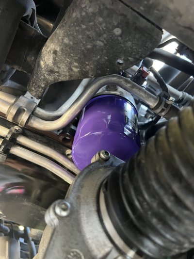

Oil sticking, the issue is the engine is hot when you turn it off so oil better known as base oil will shed of metal that is perpendicular such as lifters and pistons. You need to get the oil back as soon as possible, a good high flow filter will help. It appears you have the small filter spec, but the larger filter will work, royal purple filter 20-820. Fram endurance fe2 available Walmart is cousin to this filter. Biotech 50% success rate best to try this first, if that doesn't work redline 5w30 80% success rate at hemi tick. If these don't change the symptoms at all, I'd look hard at exhaust. You can try something else, but we know the success rates of these products with hemi tick. It is about the science, both products similar science esters plus oil soluble moly.

You have 62 ram forum Members votes are public that would disagree you cant kill start up tick. Hemi tick is generally start up tick. This is usually the cheapest out there, problem being it is only 6 pack. I would punch in 2010 hemi ram into any oil filter filament chart and it will lead you to the larger filter, those small filters restrict flow pure fact.

Its your oil filter. That's what the mechanic told me. Something about how the mopar filter is designed (that was in my 2014 Hemi).
